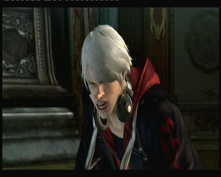

Those are some really sad looking caps. You have several problems:
1) The video is badly compressed. It's full of blocky artifacts. Are you capturing directly to WMV? The encoder can't spend the time it needs to do a good job during capture (a new frame arrives every 1/25 second) so it takes a lot of shortcuts. The solution to this is to use an encoder that's much faster but doesn't compress as much. Like HuffYUV. Then encode with a codec that compresses better later when the encoder can take its time and do a good job.

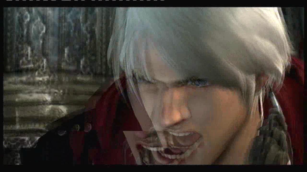

2) You have "tearing" problems. This occurs when a captured frame has the top part of one frame and the bottom part of another frame. If there is motion you get tears in the image. Some of your frames contain parts of 3 different source frames. Capture cards usually don't do this. Are you using a screen capture program or something? You should use the software that came with the device or some software that is known to work properly with it.
3) The frames appear to be blend deinterlaced already. Interlaced video contains two half picture in each frame. One half picture is contained in all the even numbered scanlines, one in all the odd scanlines. These half pictures are intended to be viewew one at a time, in sequence. Your capture process has blurred the two frames together so frames look like double exposures when there is motion.
4) Why are you capturing at 1280x720? I'm pretty sure your capture device is a standard definition device. You should be capturing at 720x576. The software may have performed the blend deinterlace when it enlarged the frame from 720x576 to 1280x720.
Here's one frame that shows all of the problems:

That's looking much better. The video is properly interlaced so it can be deinterlaced, it's a full 720x576 25 FPS PAL video with 16:9 aspect ratio flags. But you still have tearing problems. What are you capturing from? Does it have a anti-tearing option? A vertical refresh sync option? That may slow your frame rates down a little but it should give you clean caps.
Here's a sample frame from VirtualDubMod, after the Smart Deinterlace filter, no resizing, showing a tear:

I am capturing footage from an Xbox 360, the game in question being Devil May Cry 4. Looking at the Xbox settings, it doesn't have an 'Anti-tearing' option or a 'Vertical refresh sync' option. There are no options in the game that offer those options.
On closer inspection, the capturing is not responsible for the tearing. It appears on the TV when I go through a fast-paced cutscene. Could it be something to do with the cables? Or a problem with the console itself?
Oh, and another thing. The footage by itself is better. The only problem with that is I need to commentate over it, and I always do that after capturing the footage. I need to publish it in Windows Movie Maker to add the commentary to the footage, but that in turn buggers up the footage. I guess I'm in a bit of a fix? -
If you see it on the TV too, the tearing problem is definitely with the xbox 360. Yes, here's some information a quick Google search turned up:
http://features.teamxbox.com/xbox/1607/Xbox-360-VSync-Issues-Demystified/p1
It sounds like this was a decision on the part of the game developer and there's nothing you can do about it.
