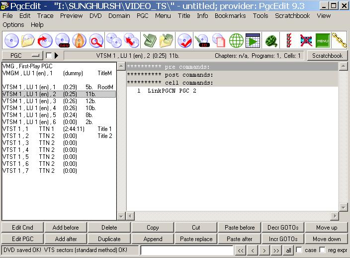

  5. In the left window you'll see all the PGCs, including the menu PGCs which you can easily identify because the number of buttons in each are indicated. Right-click the one that's the subtitle menu (do a Preview if you're not sure which it is) and take it from there. Here's a pic with a menu highlighted. Note that it has 11 buttons indicated:
