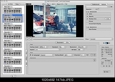

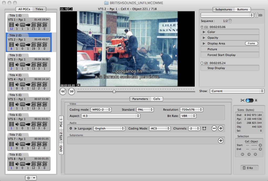

    here is a screengrab from myDVDedit to illustrate the problem
    note that for VTS 2 on the left column it says 0 subpictures, but in the preview window the spanish subs are there. i can turn them off in the subpictures section to the right of the preview by either toggling the sequence button to 2/2 ir by selecting the bottom "stop display" button. however this only seems to work for the subtitle at the cell/object point selected and not across the whole cell or track ...

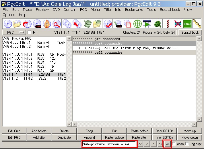

  10. Apparently it does force the subtitle. I don't know enough about it to know why the stream doesn't show up using normal methods. I think you can track it down and disable it, though. In PGCEdit do a search for this:
    Sub-picture stream = 64
    You do it in the bottom center of the main screen. Just copy and paste what I wrote, noting the spaces on either side of the equal sign. Then hit 'All'. After you find it, right-click on it and (probably) delete the command.

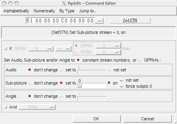

    the only "Sub-picture stream" command found is "(Set STN) Set Sub-picture stream = 0, on"
    in case it makes any difference, this command is part of a dummy VTSM file called "VTSM 2, LU 1 (en), 3 (dummy)".
    i have tried changing this value to "don't change" or "off" or "not set" or switched it to various other numbers (such as 31) but none of these stop the subtitles from appearing.
