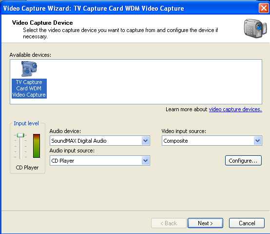

however, it finally all came together
see the attachment, note the audio device selection box. i kept wondering why that was there. it didn't make sense, i thought the audio was somehow imbedded in the video stream and if that was so, why would it care about an audio device? i was thinking somehow the capture card audio got streamed to my audio device, the sound max, WRONG. and if audio was embedded in the video stream why are there audio jacks? duh
ok so the video and audio are separate but joined? streams. the smart electronics keeps them in sync?
anyway i plugged the mini jack into the blue jack on the motherboard/soundmax, and even figured out to set the audio input source to 'line-in' and viola sound and video

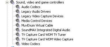

the device mgr has one entry for the capture card, no subdivision for line-in, the usual msg, device is working properly, there are a number of devices listed though, see attachment, my capture card is the tv capture card wdm video capture
