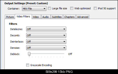

    With all filters off, it does a weave for interlace source*. Interlace source can have "Detelecine", "Deinterlace" (Yadif) or "Decomb" filters applied.
    One needs to examine the source for telecine pattern. There is no autodetection.
    * Handbrake does not offer an x264 interlace (MBAFF) option.

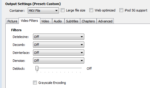

  14. What would happen if I set De Interlace to OFF in the dropdown list and then turned Decomb to OFF??
  15. Member edDV's Avatar
    Mar 2004
    Northern California, USA
    see my response in your other thread.
