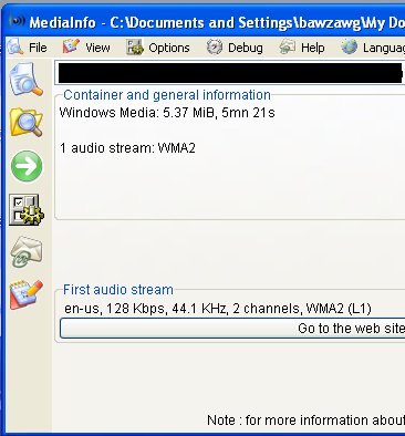

There are a few different versions of the WMA codec. The 5990 plays WMA2 but it doesn't seem to like WMA1. Also verify that your files are really WMA -- try MediaInfo. Anyone can rename a file with whatever extension they want. Many media players will be able to figure out what type of file it is by the content. The 5990 doesn't.
Well Jag', I took your advice and grabbed that wee prog' you mention. They are indeed wma2 files as the screen-shot I'm posting will show. Thanks for your help . . . any other thoughts on this?
