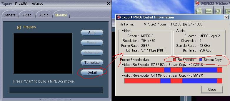

In Womble, before starting the export, if you click on "Details", does it show it will encode or stream copy?
See the attached pic for the example.
If it does show video encoding instead of stream copy, in the Export menu, go to the "video" tab and select the "Reference" file and hit "Select". This will update the video output specifications. Then, look at the details and all the video meeting that specification (resolution, frame rate) should be a stream copy, like with VideoRedo, instead of encoding.
