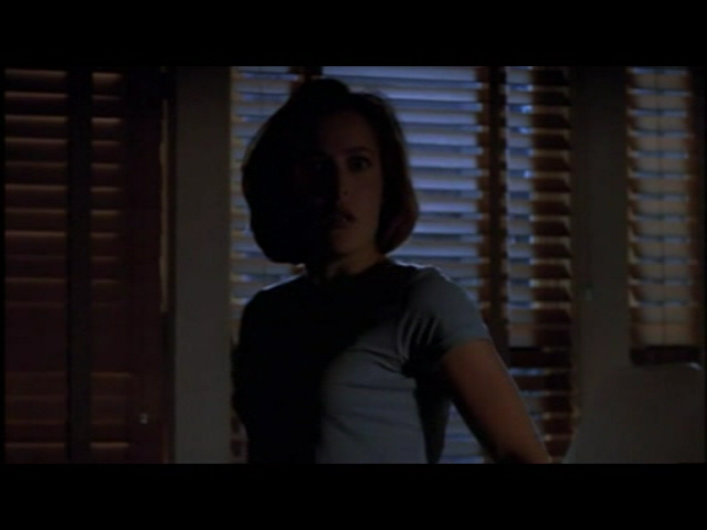

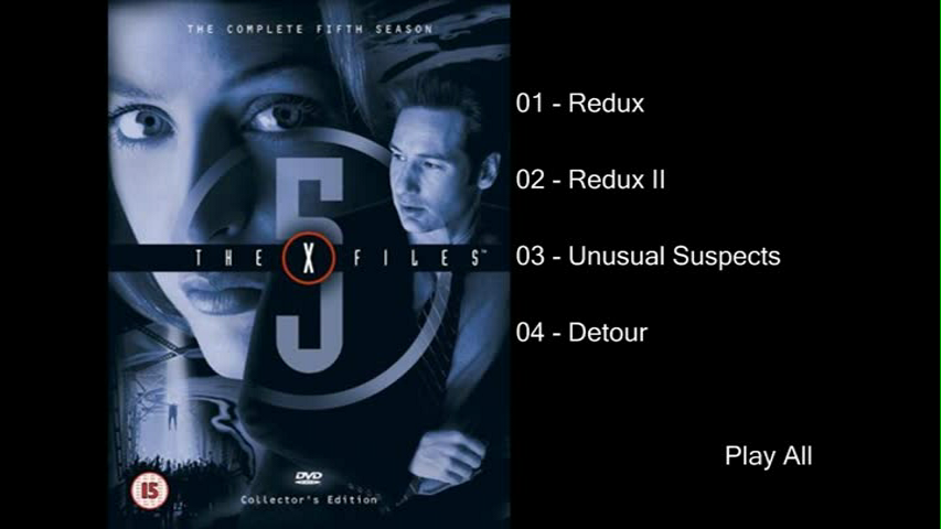

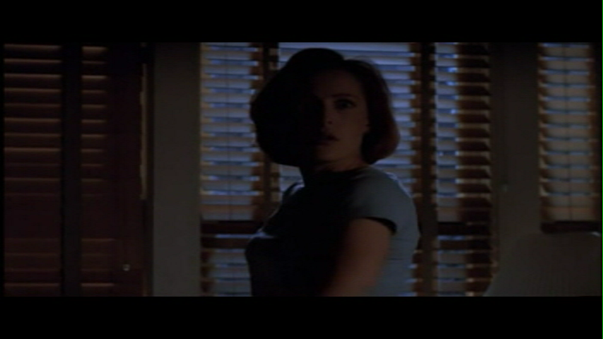

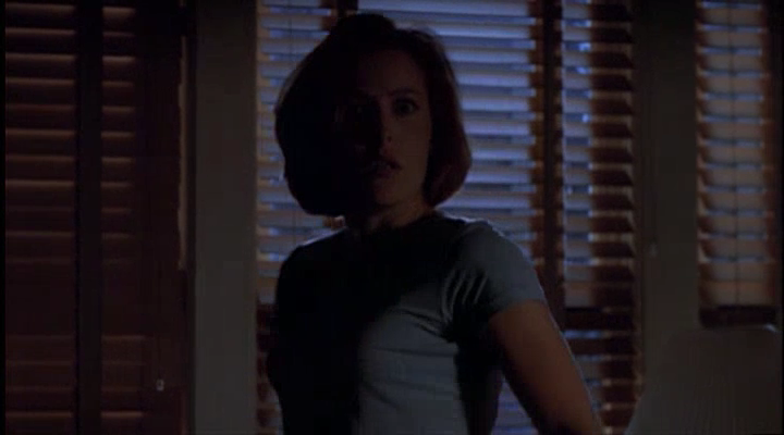

Attached are the following screenshots.....
Menu - correctly set at 16:9
Original - snapshot of the original 720x400 h.264 video
non-forced aspect ratio - snapshot of the encoded video when aspect ratio is not forced to 16:9
16:9 forced aspect ratio - snapshot of encoded video when aspect ratio is forced to 16:9

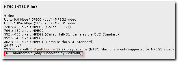

And yes half D1 doesn't support 16:9 Anamorphic (https://www.videohelp.com/dvd):
So you have the info – either reduce the full/half D1 threshold or put less duration on the DVD.
