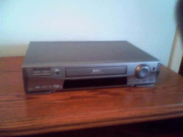

I have one-purchased a couple of years ago-but never hooked up-have the manuals and such...
