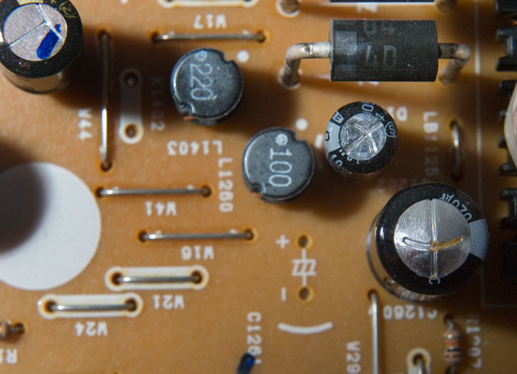

- October 2007 - Turned it on one day, and it started to hiss at me. There was a buzzing noise coming from the unit. It ONLY happens when a disc was spinning in the drive, or randomly at other times. I first thought it to be a drive dying. Unplugged machine. Took it apart, look inside, saw nothing.
- January 2008 - 1-2 weeks ago - plugged back in, to use on a project.
- January 2008 - TODAY - It was blinking 12:00, I went to turn it on, and the clock disappeared. It started to chirp at me now, instead of buzz. Once again took it apart, and noticed a brown leakage coming from a bulged capacitor. It reminded me of this post here: https://forum.videohelp.com/topic255081-480.html#1777964

So am I correct? If so, I take it that this can be fixed easily by somebody handy at electronics. I've never tried to do this before. I've got no idea where to start. Any help?

Assuming the only problem is the leaking cap, it can just be replaced. It would best be done by a qualified tech, but you could likely do it yourself if you are fairly handy. The main thing is to ensure you don't overheat the board and/or surrounding components (especially the new cap you install).

The pictures look as though they are of the same Electrolytic Capacitor.
The one shown would indicate it popped is leaking and than most likely Opened.
I can not see the value but the one in back and to the left indicates it is a 220 uf
The defective one should have a uf value on it
I don’t know the Electronics parts situation in your area but Radio Shack should have a solder gun for circuit boards [25 watts Max] and the capacitors. 15 watts would do
The leads are through the board 180 degrees apart and soldered.
Placing the heat gun at one solder connection and gently pushing back towards the other lead should release it.. [Than the other lead]
Note these capacitors are polarized + and -
When replacing Cut the capacitors leads to about ¾ inch. This will help in replacement
Heat the board connection and push a lead through about half way than the other until seated.
If the replacement is larger or /and the leads are closer of farther apart, and the replacement is not down against the board that’s OK. Clearance would be the only factor
Once the replacement is in place make sure the leads are properly soldered and connected. Than clip off the excess leads
The capacitor voltage is usually some 50 v if higher, that’s ok, It is the uf value that can be important but is not always it the replacement is within about 15%
I agree with [Krispy Kritter]
But I feel that the danger is with the board. Not so much with all but some if even over heated a little had a tendency for the conductive trace to lift off the board. This could be fixed but increased the problems. -
