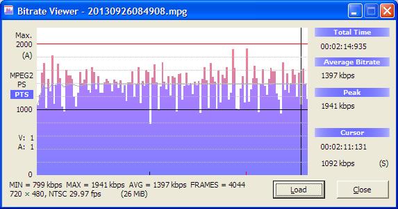

    Mar 2008
    Hi MrC,
    I have a scenario for you. I captured a small clip through my PC tuner card. The signal is digital,
    clip is SD, fps 29.97, resolution 720x480. At first glance it appears DVD compliant so A2D does not re-encode it.
    However, at the authoring stage, Muxman rejects it because the number of GOPs:
    " Multiplex operation failed, GOP contains more than 36 pictures at 1575596 of (null)"
    The only way I could create a DVD was to run DGindex myself, outside of the program, and then feed the D2V to A2d.
    It seems in some situations A2D itself prompts you that DGindex is advised, and creates it for you,
    but not his time.
    I can provide the source file if you'd like it, it's 26MB.
    regards,
    Dave

    Mar 2008
    Yes, I can see from the programming, you're checking frame rate, bitrate, aspect ratio and resolution.
    Perhaps the GOP organization is something you don't have access to via Mediainfo.
    Here's the clip.

    Mar 2008
    Sounds good. Where is the MAX bitrate from ? The mpeg header? Using the bitrate viewer, it gives this info.
    Gspot can give GOP info. Can you use that?
