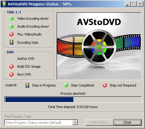

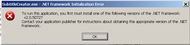

    It sailed along OK til I got to the subs encoding then it aborted saying .NET is required. A waste of 6 hours. I guess I can't use it if I want subtitles. Too bad...
    P.S. I found that version of .NET at oldapps.com and have installed it OK. It was a PITA to turn off all of the resulting MS update attempts, but I finally got it done (I think). Now I'll give another shot at the encoding with subs...

    Sorry about that. I wasn't aware that one of the programs that AVStoDVD uses needed NET. If you look in the folder that you designated for your Assets path, you may have the audio and video already finished. You could import the video, right click on it in the main window of AVStoDVD and then import the audio and subtitle streams (assuming you have the subtitles in a separate file already).
  9. Actually it is SubtitleCreator that needs .NET Framework, and, AFAIK, the more recent releases are ok too. At least the release that comes with W7 is ok.

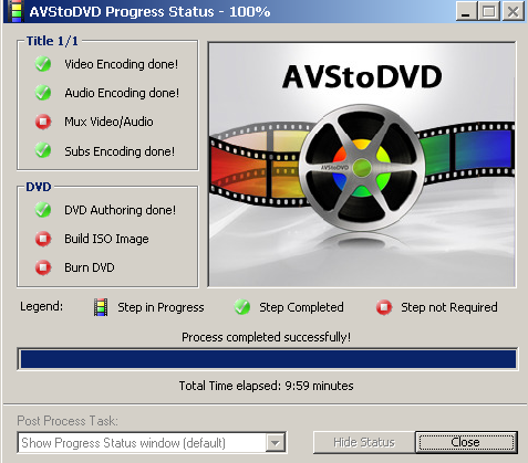

    Thanks for your help. I seem to be over the hump with this one...

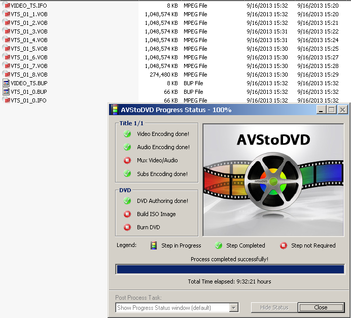

    1.41 GB 656/480 128 kbps .avi B&W movie 2:01:45 -> DVD9
    No complaints about oversize this time as I decided to try a DVD9 conversion.
    The subs sailed thru without a whimper after installing .NET 2.0, and they actually work *correctly* after the error was fixed by AVStoDVD. They didn't work right in the original .avi or with the DVDFab Creator conversion.
    The quality seems about the same as the original .avi, no jerky motion during action sequences, good contrast and sharpness. The bitrate is about double what I got with DVD5. I'll probably use DVD9 for all my conversions, don't have very many to do...

  11. ...C O P Y L E F T JohnnyBob's Avatar
    Feb 2007
    Earth
    Yes, I have the .m2v and .ac3 files from my original DVD5 conversion but can't figure out how to import them. I've rightclicked various places in the AVStoDVD main window, as you indicate, but there is no offer to "import" anything. Presumably all I need to do is import those two (video and audio, previously converted) then let it convert the subtitles which caused the abortion. That would save about 5 hours. But how?
    (I'm afraid the special terminology of projects, assets, etc is still not in my vocabulary!?)
    Nov 2003
    West Texas
    Use the green + sign on the right to import the m2v file. Once it is in the main window, right click on it (the line showing the m2v file), and you will get a pop up list of options, which include audio and subtitles. Move down to the audio line in the pop up list and you will be able to add the audio in. Do that again for subtitles.
