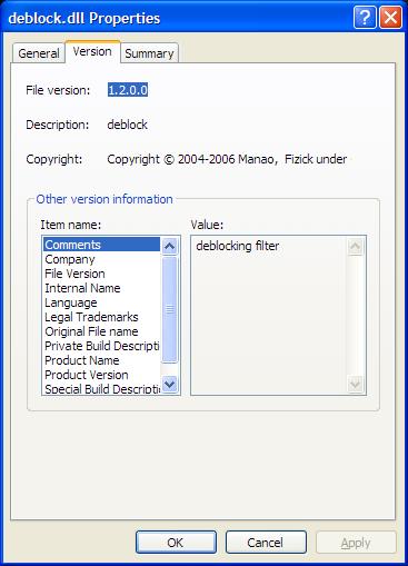

    MrC, regarding Deblock(),
    I looked in the Avisynth plugings folder and found deblock.dll, I assume this the main, perhaps only file necessary.
    Here's the info from the version I have:

  16. @davexnet
    regarding DeBlock, default Avisynth installation does not include it, but it is included in DGDecode.dll, part of DGIndex project. Thus it can be easily implemented into AVStoDVD.
    Expanding the scope, there are a bunch of deblocking filters. Do you have experience with any of them, other than DeBlock?
    Bye
    MrC
    AVStoDVD Homepage
    Mar 2008
    Originally Posted by _MrC_ View Post
    @davexnet
    Bye
    MrC,
    as far as I'm aware, I've only used deblock.dll, I posted the dll info with a screen shot a few posts back.
    I understand there are some other choices. Perhaps we can research a little further. Some others in the forums
    may have some comments. I've seen some sample scripts with deblock() mentioned - appears to be a general
    purpose tool - works pretty well.
    Doesn''t the facility in DGDecode.dll only work for mpeg/VOB source?
