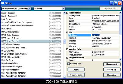

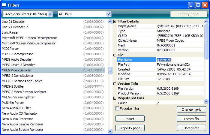

    Mar 2008
    Mike, most of the MS codecs are all in one program, quartz.dll.
    You can review the gory details in Graphstudio or Filmerit:
    In addition to the audio & video codecs I previously mention there are over 100 dll files, but I did not see a quartz.dll file, at least not viewing these through WMP. I took a look in the windows\system32 directory & did not see it either. I’ll try one of the programs you mentioned & see what I can find.
    Thanks for all the information.

    Mike, I did my screen shot from XP. It's entierly possible the names have changed in Windows 7.
    Is the name important?
    The name is not important at all. I was just trying to figure out where some of the codecs were located.
