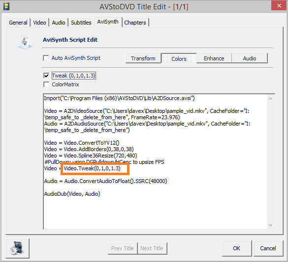

  12. Hello,
    I have a problem with contrast setting (AviSynth -> Colors -> Tweak -> CONTRAST): it accepts integers only (0, 1, 2, 3, etc.). "1" means no changes, "2" is to much contrasted for me. Then I try to type "1.2", it says: "Warning! Inserted value is invalid." It also means it is impossible to decrese contrast, since "0" gives black screen.
    The same situation with sharpen (AviSynth -> Enhance -> Sharpen) - integers only.
    What am I doing wrong?

  14. Originally Posted by davexnet View Post
    Works OK for me, are you using the latest release?
    Try a comma instead of a period (eg. 1,2)
    I'm using release 2.8.9
    I doesn't work - "1,2" or "1.2" - the same warning about invalid value.

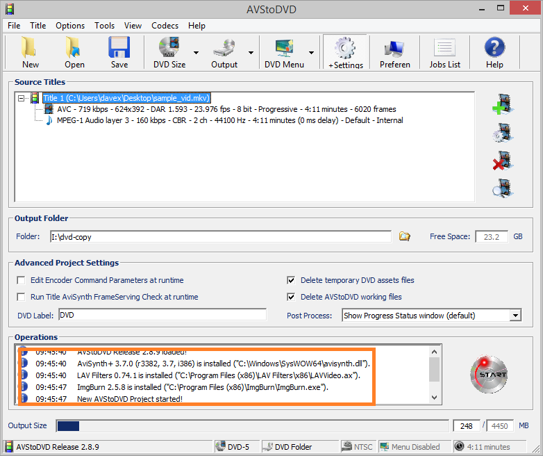

    Mar 2008
    Are you running the installer version of the program or the portable ? If it's the portable version did you install the
    Visual Basic common controls?
    For the portable there is a BAT file in the install folder \LIB mscomctl_reg.bat (right click run as adminstrator)
    Have you checked the Windows Language settings ? Just give it a glance make sure everything looks OK
    https://support.microsoft.com/en-us/windows/manage-display-language-settings-in-window...a-dba919c52321
    Any error messages on the main AVStoDVD window at the bottom?
    Also, nothing to stop you editing the script directly - it will give a warning (turn red), that's all

  16. Member manolito's Avatar
    Jun 2009
    Germany
    What is your system locale?
    Can you try to enter an integer number under AviSynth -> Colors -> Tweak -> CONTRAST and then edit the created AVS script and replace the integer with a float? E.G. enter "1" for the contrast and click OK. Then edit the newly created AVS script and replace "1" with "1.2".
    The AviSynth tweak filter certainly accepts float values, so it should work as long as there really is a float value in the script. If for some reason this value is not a correct float number (like 1:2 instead of 1.2) then you will get such an error.
    Oops, just noticed that davexnet was faster than me. But basically we are saying the same thing...
    Mar 2008
    Hi manolito - thanks for chiming in
  18. I have installer version. Warning apears after confirming (pressing 'OK') Tweak settings.
    As for Windows language settings, it's Polish in my case.
    I edited the script, the text turned red, but it works - contrast is changed.
    So thank you all for your help.

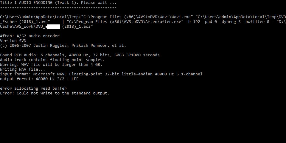

  24. Member Seeker47's Avatar
    Jul 2005
    I had just configured AVS v. 289 on a Win-10 box, with settings pointing to the LAV filters. On the first project attempted, it bombed out with an error that I don't recall ever seeing before. The video file was a pretty ordinary MKV, I thought, which would have gone to a standard, single-layer DVD size. Admittedly, it's been some time since I ran AVS, and that would have been on a Win-7 box. Maybe someone can explain what happened ?
    [Attachment 60259 - Click to enlarge]
    [Note: there was one of those 6 channel / 2 channel mismatches reported when I queued up the project, and I directed it to go with 2 channels.]
    [Addendum: O.K., this seems to have worked out and amounted to a 'Never Mind.' I dismissed that screen above, thinking that AVS would probably just terminate, with the project being a scratch. Instead, it went to a backup routine using some other sound processor. (?) This went by too quickly for me to catch the details. At the end, the last report from AVS indicated a running time result that was 8 minutes shorter than what the source ought to be. But when I went to play that DVD result with VLC, it showed the full, expected running time. Moreover, there was no apparent loss of sync with speech, voiceover narration, or the hardcoded subs. The source was reduced from a Blu-Ray level resolution down to that of DVD, but as expected, and it looks fine. I don't know where that "4 GB worth of sound" from the error message figures in, or what the cause might be, but all's well that ends well.

  25. Member
    Mar 2008
    Did you run out of disk space? Post the A2D log
  26. Member Seeker47's Avatar
    Jul 2005
    Not nearly: there is almost 2TB of free space available on that work drive.
