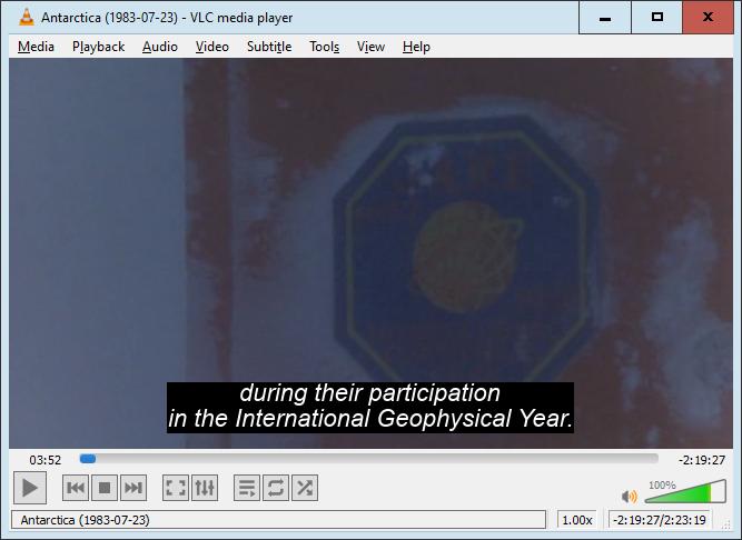

  3. Or set the subtitle renderer to produce a black box behind the subs. Or convert the subs to SSA format and specify a black box behind the subs.
    VLC with background opacity set to 255:
    [Attachment 60815 - Click to enlarge]
