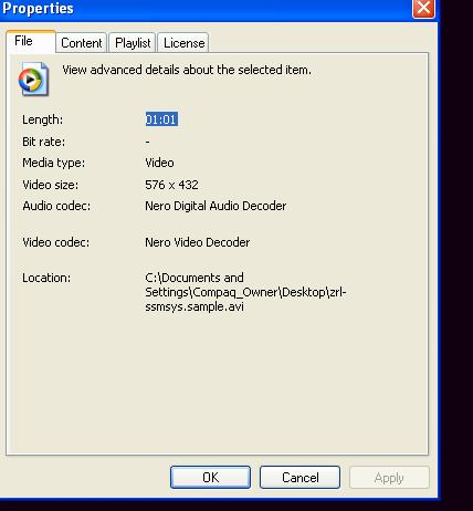

    i realised something :
    --after uninstalling, windows media player tells me that it uses nero video decoder. (see picture)
    --Previously, with divx 6.6 update installed, the video decoder part is blank.
    --i dont' have xvid codec installed. since i bought this computer, i've only installed nero and divx 5.21. nothing else. updating to 6.61 caused this problem

    With the divx codec installed, it should have said "DivX Decoder Filter" in wmp and not blank.
    After you install divx if it's not the default decoder, In windows/system32 find divxdec.ax and install it. I associated ax files with regsvr32.exe so when I double-click on an .ax file it installs the filter.
  4. Regarding upside down video in Divx: go to the Divx Decoder Configuration Utility and turn off "Use advanced hardware overlay". Or try updating your graphics card's drivers.

    btw, whre's my nero decoder come from? is it with nero vision express? can i set it as default decoder after installing divx 6.6? because after installing divx6.6, the decoder part turns blank as i've said. nero video decoder(before divx6.6 was installed) on the other hand, works fine.
