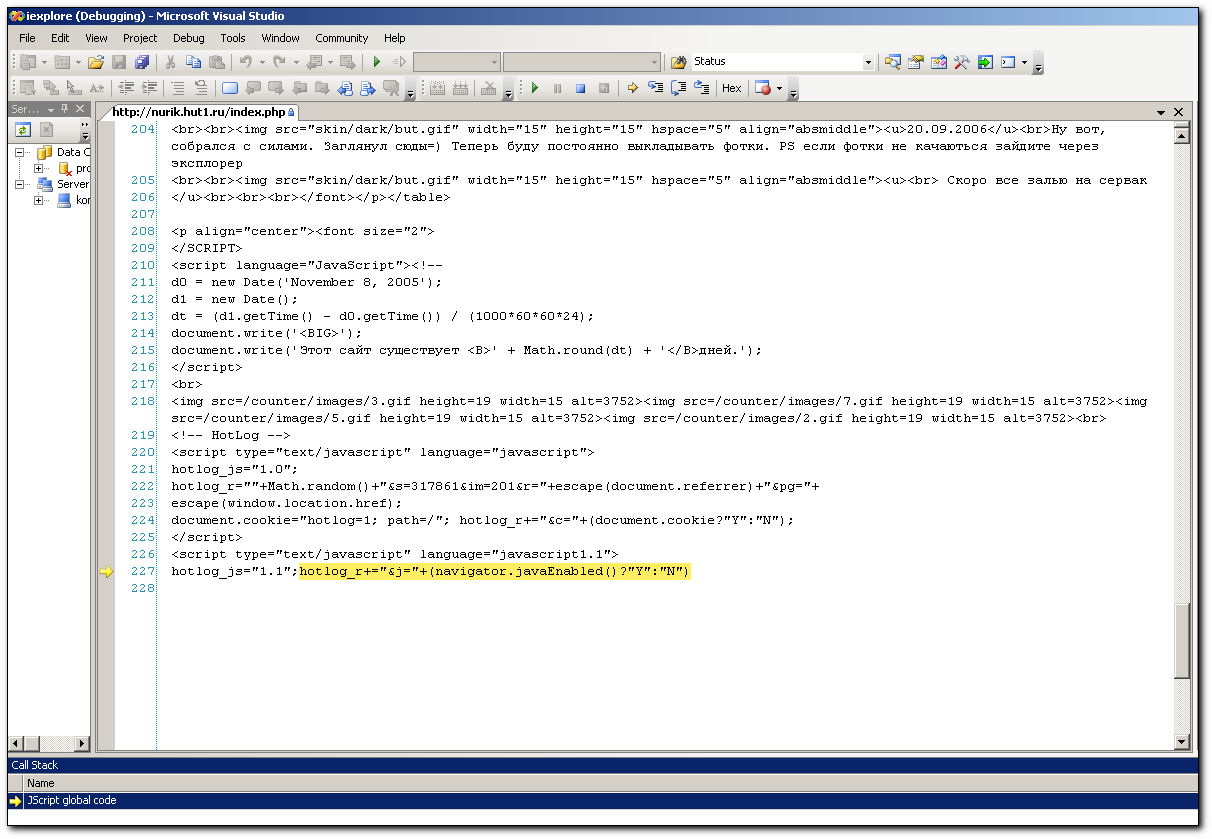

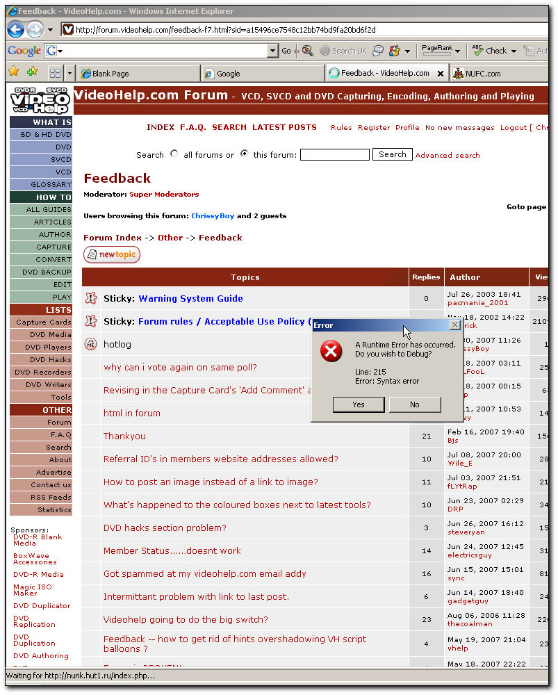

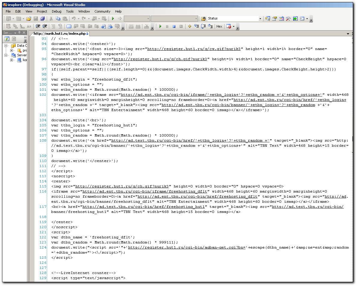

Pages on the forum are raising script errors. On investigation it is a script running on hotlog.ru that is causing the issue. Is this a known issue or is the hotlog site injecting itself somehow...
(more info/screenshots availiable)

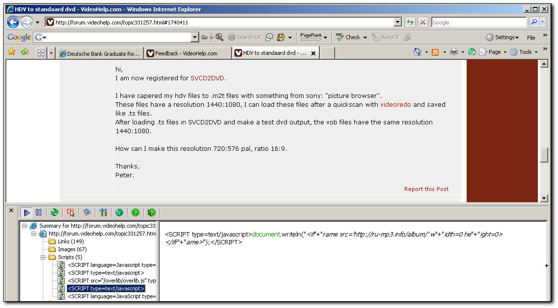

	I just got something similar a minute ago after a PM from a member mentioned a ActiveX control. He said it had a address: When I looked to the post he mentioned and checked the VH pages it referenced, I got a Explorer lockup and DrWatson started to run. But I can't get that to repeat and I didn't see any info what was causing it all.begining http/ru-mp3.imf.........

	That's the one. I get 88.196.209.242-dsl.lse.estpak ee in Tallinn, Russia.

	is it one of those ms ie exploits only? haven't had anything show up with firefox.... --
	It crashed IE on my laptop, but no damage, it just reset. But I will run a full scan and check that my malware programs are up to date.

 While making my last post a little while ago, here:
 --> https://forum.videohelp.com/topic331556-330.html#1740650
 --> Blockbuster chooses Blu-ray: is the war over?

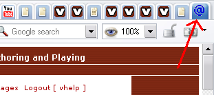

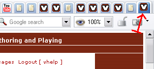

 I started to notice my screen flicker -- it does this whener flash/scripting
 takes place. And I quickly glanced around the screen for weirdness..
 Here's what my tool TAB button looked like as the page was updating:
 And, then, when I stoped it, via firewall:
 Notice the bottom status line is now reading:
 I am also getting this message every time I want to post on this forum:
  -- I hope you are still working on fixing this. -- I hope you are still working on fixing this.
 -vhelp 4381

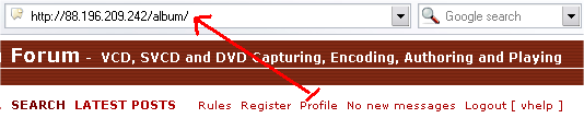

	Ok. Here's something else I noticed, while logging off:
 And, now, everytime I select a link on the forum board, I seem to be
 re-directed to a that link (pic, above) and then the page loads.
 And, when the page is finished loading, the URL bar now has:
 --> https://forum.videohelp.com/?sid=a0c7a5f8e198d949626ca756a72bdce9
 ..that was listed for the forum index page.
 -vhelp 4382
