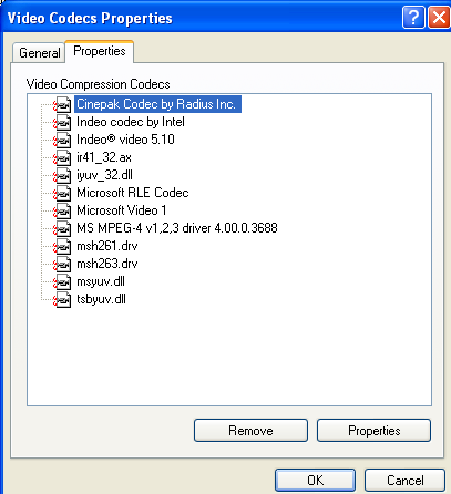

okay i tried Panasonic DV Codec but it sill didnt work so i uninstalled it. then i tried Cedocida but that didn't work either, so i uninstalled that too.
what more can i do???
here's a pick of my vieo codec properties. what am i missing? whats going on?
plz plz help. i rely want this to work!
video_codecs_properties.jpg -
It looks like you should install the XviD codec. (You can find it here).
