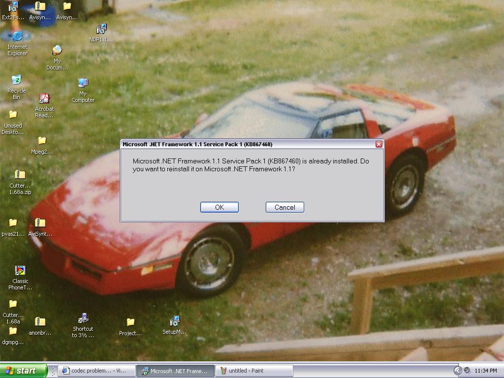

    Mar 2007
    Like this?

    Mar 2007
    Well, I'm completely confused.
    Doesn't .net 1.1 SP1 = .net framework 1.1 service pack 1?
    I downloaded it from their link, and WIN GEN ADV confirmed authentic windows d'load.
    Their support forums don't translate; only the home page.
    Does anybody have a clue?
