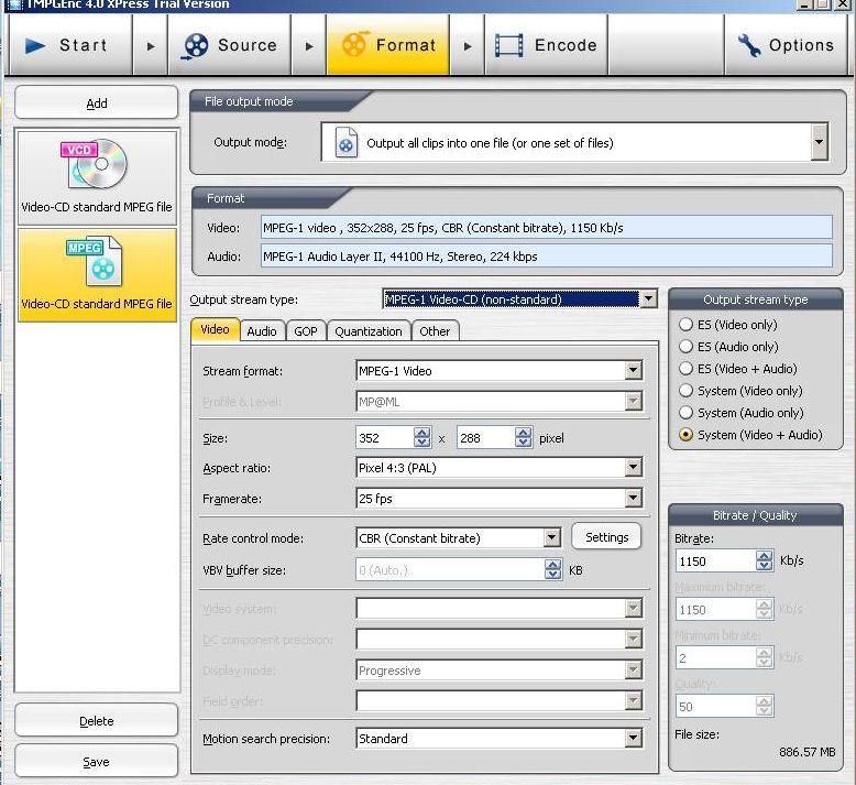

just tried again, selected the bitrate n the file size was to be 886Mb but the file ends up at 1gig in size...
anybody know why the file u end up with isnt the file size it tells u in the settings -
Because your source file contains VBR audio? Or you're using VideoCD multiplexing instead of Video CD Non Standard. I'm sure there are other possible reasons too.

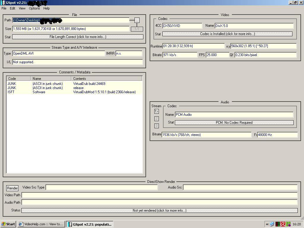

Wiser heads may weigh in later, but in the meantime a few comments
1) TMPGENC is showing standard MPEG1, 1150 kb/s. I thought the idea was to use non-standard lower rate?
2) The AVI is 88 minutes long.
The 847 MB version you mentioned earlier would probably be about right for standard MPEG1. That would fit onto one of the larger capacity CDRs I mentioned earlier.
The AVI also shows PCM audio. Which is very wasteful of space, but most compatible for conversion, so that shouldn't be a problem. -

Let's put it this way...
bitrate and filesize are intricately linked, but the exact ratio will depend on the codec used. It can be stated that given a constant codec, the higher the bitrate, the bigger the filesize, and vice versa.
Codec, or the way the video (and audio) are compressed, will determine the ratio of compression (and thus, the relation between bitrate and filesize) but it's NOT an exact relation as different content will compress differently. "Talking head" type videos compress a lot better than high-motion video, for example, and some codecs are better at certain things than others.
The bitrate calculator will never be "precise", as it doesn't really do a full analysis of your video file (since that would take as long as actually doing the job!) It basically takes your video length, multiply by the "average" ratio and the desired bitrate, and come out with a predicted filesize.
If you tried it twice and it keeps coming up with a file larger than expected, then you'll just have to use a lower bitrate. Do a little calcluation on how many percent you run over. Say you run over 10%, decrease your bitrate by 12%, and try again. You are aimming to undershoot, not over. It's a matter of experimentation. -
