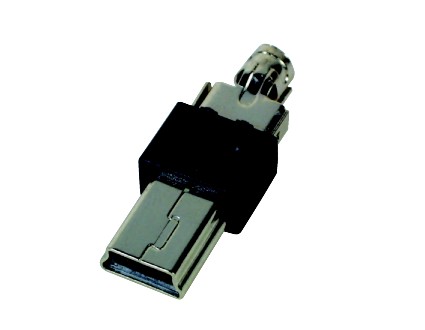

    In that site you linked to, that looks like a mislabled USB to USB mini adapter, not Firewire. Mini Firewire looks like this:
    And USB Mini B like this:
