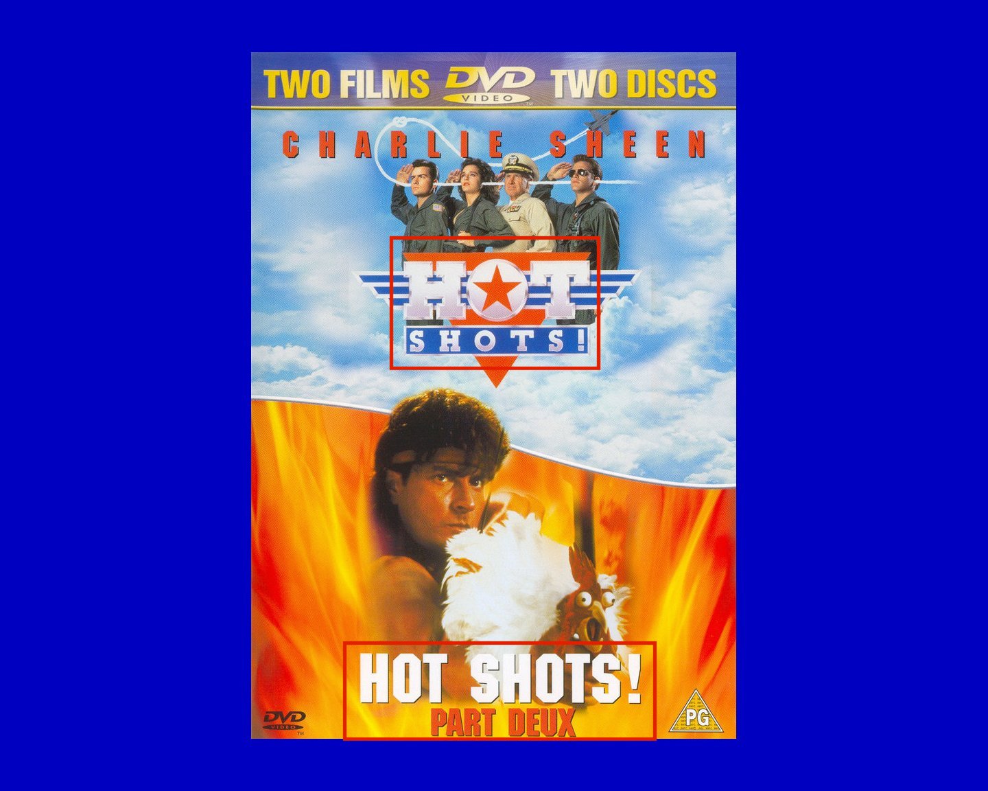

, and secondly, I find the standard menu a touch bland. Especially something as fundamental as not knowing which is Disc 1 and which is Disc 2 (or Disc 3 and possibly Disc 4).
My imported menu is generally just something as simple as the following:
I just bought Hot Shots 1 & 2 as seperate titles and thought I'd combine them to a DL DVDR. The highlighted item's red rectangle fills with a transparent red covering (to indicate that it is selected), and fills with transparent blue when confirmed. The rectangle outlines aren't there, I just used them to outline the zones.If in doubt, Google it. -
I don't care if its bland, it serves its purpose to be a simple menu letting one choose between the two discs. As for knowing which one is disc 1 and 2,etc.Originally Posted by jimmalenko
If a movie and its sequel are on the same disc, simple common sense would obviously imply that "Movie 1" would be "Disc 1", and the sequel would be "Disc 2".
You could also include such information on the DVD-R label too, simply by putting a "1. or 2." at the begining of each name. Not that hard to figure out. -

... provided you imported the discs as assets in that order, of course.Originally Posted by [url=https://www.videohelp.com/tools?tool=SUPER_1
I was talking more about when you have between 2 and 4 features merged onto the one disc that may or may not be related in that matter. For example I chose to put three "Unauthorised Biographies" series DVDs (Metallica, Bon Jovi and Linkin Park) onto the one DL DVDR.
True, but unless the top of your DVD player is see-through, I cannot see what's written on the top of the DVD-R when the disc is in the drive and spinning !Originally Posted by Super Warrior
But anyway, whatever floats your boat I guess.
I don't spend a helluva lot of time on menus to be honest - just enough to ensure that I can navigate around OK, but while still giving a little eye-candy when showing friends etc etc.Originally Posted by daamonIf in doubt, Google it. -
