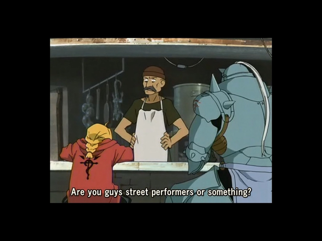

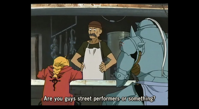

    Fellas, I downloaded AviSynth and FitCD. I was watching one of my Full Metal Alchemist episodes and appearantly overlooked it as it was one of the defective AVIs as far as the Subs were concerned.
    I had no idea that you could substitute an "avs" file in place of the actuall MPEG or AVI? My head was spinning when you all kept saying it would save a lot of time because I was thinking I would still have to use TMPGenc Xpress, which is slow. After I made the AVS file, I started wondering if my favorite encoder, WinAviConverter could accept that format and what do you know, it did.
    Here is the before pic:
    Here is the sub after using the FitCD method:
    Looks like I have a new favorite software
    - Mike G.

    Anyways I was happy with how the first episode turned out as I could see the subtitles completely on my TV. I used a TV OVERSCAN of "2" and remember I converted it to 16x9 WS.
    This is what it looks like:
    Of course on my TV a bit gets cut off all around but the subtitles are still a good inch or so above the bottom of the TV screen on my 51" 16x9 WS HDTV.
    - John "FulciLives" Coleman

    Here is what it would look like on a 4:3 TV
