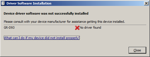

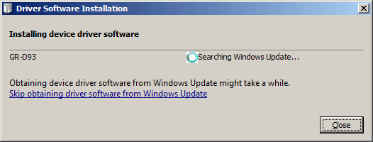

    If you still have this crap software, could you share it? Or at least the USB driver for Windows. My Windows 7 could not find it, and JVC website does not show it. Thanks!

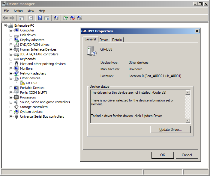

  9. I googled around, found this link on Fixya: http://www.jvc.ru/files/software/gr-d53_d73_d93.zip Obviously, the link is dead, but after searching for the zip file name I found one here: https://devid.info/en/27235/JVC+PIX-MC10+Downloader+Driver In the zip file there are two EXE files. It is not very prudent to run EXE files you find on the Net, but really, who would be stashing viruses in such an obscure zip file? Filenames are:
    • UsbSTG4E.exe - USB Mass Storage Class Driver
    • UsbVSP.exe - USB Video Streaming Driver
    The first one supposedly is for 16-bit Windows only. I tried running it, and it reported "Windows 98 only".
    The second one is a JVC proprietary driver for streaming video over USB. So... I tried it on Windows 7 64-bit and it did not work. Oops.
    If any JVC DV camcorder owner comes across this thread, please post your solution for streaming over USB.
    P.S. I haven't even tried connecting this camcorder to a Windows 10 machine.
    P.P.S. The JVC document I found elsewhere states that one needs to install four software items in sequence, so maybe there is something missing here? IDK.

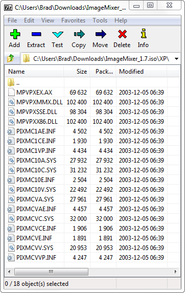

    The manual for the camcorder refers to another document for info on how to actually do USB transfer.An Archive.org user has shared an ISO image of the ImageMixer 1.7 software / USB driver install CD.
    Confusingly, the necessary drivers are in the XP folder on the CD-ROM. The DRIVER folder contains those EXE files you already have, which as you found out are the Win98 versions of the drivers.
    Once installed, you should have four "devices" in Device Manager:
    • [JVC PIX-MCV Video Capture] in [Imaging Devices]
    • [JVC PIX-MCV Audio Capture] in [Sound, video and game controllers]
    • [JVC Composite PIX-MCV Device] and [JVC Communication PIX-MCV Video Driver] in [UniversalSerial Bus Controllers]
    The PDF for the software describes the files you're going to get via USB as MPEG-1.
    I've attached the drivers by themselves, if you want to try manually installing them without the software.

  17. Brad, thanks a lot! I tried the drives in Win7 64-bit - did not work, Windows would not install from them, did not treat them as installable drivers. OK.
    I have an old Win7 Home 32-bit netbook, it is slow as hell. I was able to install the drivers as JVC predicted, first having three misconfigured devices, and then I would install driver for each of them. Ultimately, all errors were resolved. See attached image.
