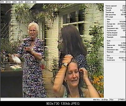

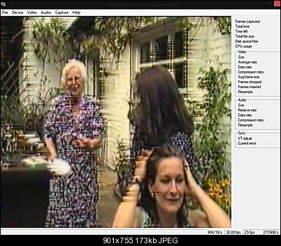

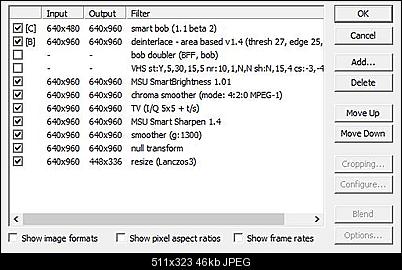

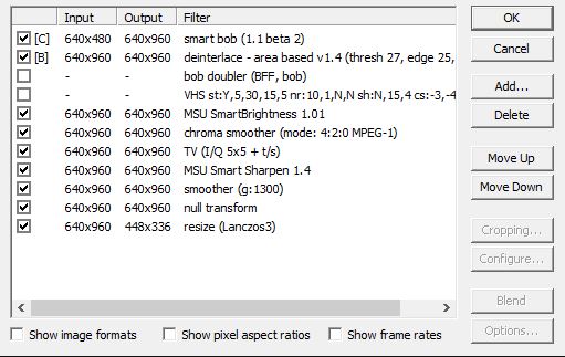

    I have to digitalize 12 vhs videos. someof them are 8mm on vhs and old! 1939-1994I am new to this and use a logilink graber with virtual dub.
    I use the folling filters chain.. see pic.

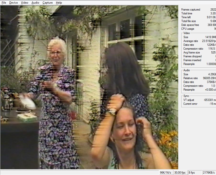

    and need help on getting those... spikes/lines? see pic
Name:	video bearbeitung.jpg
    if I would know what is the name of those lines. I could search for.. but I don't know it.
    after using smart bob AND deinterlace area based they became less. but still are a lot! imagine how full the picture was before using both
    so if you know the name of those lines/spikes, noise... let me know and if you have a solution please tel me. of course I am happy to know what are better filter chains if you have some working better.

    thank you for such a fast answer.what is the NAME of such lines?!
    as I could read, tbc is buffering somehow and putting things after buffering together. so is there any filter that do it with virtualdub?! my computer is powerfull enogh to buffer some video
    my vcr is a sony slv e500 and I saw some TBC VCRs... few hunderts just for 13 video plays?! because after that no cassette will be put in that expensive box! and I have to put few hundert dollars in the garbage.

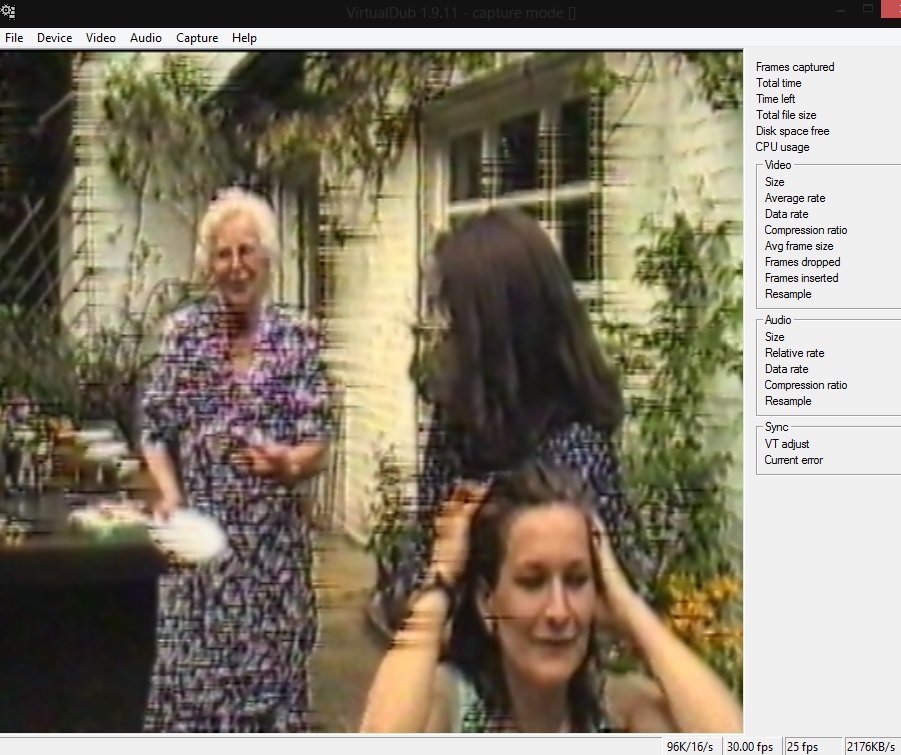

    by the way. the original was this, would you change anything on the filterlist?
Name:	video bearbeitung2.JPG
  21. No, nothing in VDub can fix that mess. Maybe it's also caused by dirty heads, but that's beyond my knowledge. Someone will come along soon that knows more about what causes that and how to fix it. Hold on...
  22. I recall Jmac's advice on how to deal with exactly those same black lines. You have to capture the video 2 or 3 times and use his script

    I don't think a TBC would help this at all, but a different VCR probably would. The heads of the record or playback device are damaged.
    However, if you bought an expensive VCR (e.g. from eBay) for just 13 tapes, you would sell it after you finished (e.g. on eBay) for about as much as you paid for it. They only way you'd lose money is if it broke in the meantime.

    That distortion in the photo's above look very similar to something I got when I tried to playback an S-VHS recorded tape
    (may have been S-VHS ET) on a player that didn't support it.
