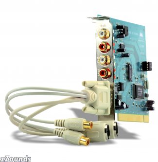

I meant to ask... are the RCA plugs that are connected to the card for input or output (the white cables with gold tips), not the actual inputs, but the cords that are connected to the soundcard in this picture.

Have you gone through the manual? They usually go through the "gozintas" & "gozoutas" pretty well, and it may be kinda card specific how they set up their driver & interface. If it isn't explained well, I'll try to get through it with you tomorrow night.
Alright, thank you, take your time, just let me know whenever you get the chance. I've looked through the manual several times, but unfortunately I've found nothing. So I appreciate your help!
