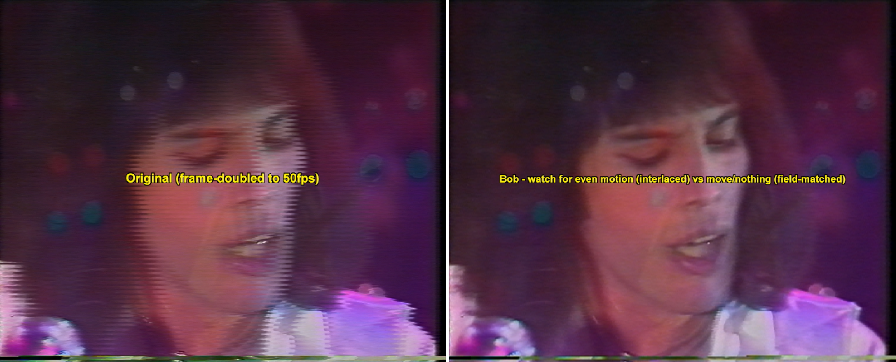

Well, there is motion within them, and this is when the comets happens on that capture.
Here's a screenshot of later on in the video, left is the original, and right is deinterlaced.
This is just a test mode I use to check if the video is interlaced or not.

Also se p-seg5 attached, which has a lot of movement, clearly interlaced. However never any comets... -
Yes. basically interlaced with occasional hickups of dropped and repeated fields (p-seg5) of which I do have some doubts as to these are intended motion artwork or just capture flaws.
