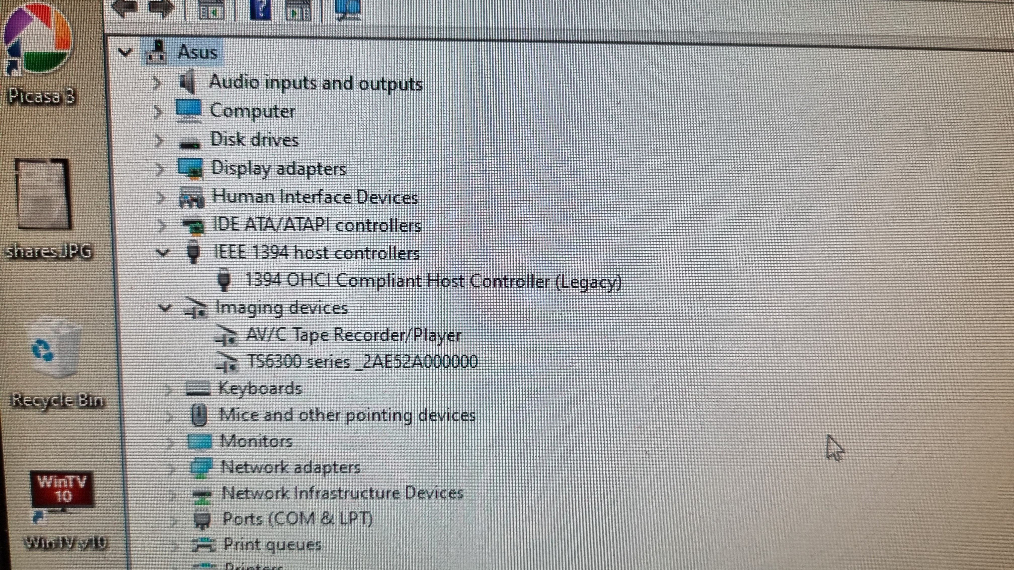

    Working OK here (PAL setup) with WinDV (the ADVC-100 comes up as a "AV/C Tape Recorder/Player", as you've noted). I too get no video from Scenalyzer.
    Here's my Win 10 Device Manager:
    [Attachment 92961 - Click to enlarge]
    That's using the "Legacy" Windows Firewire driver.
    I have extensive info on WinDV and the Firewire driver setup on my website here.
    Apologies for the screenshot; I have Win 10 on my other computer and CBA doing a proper screengrab!

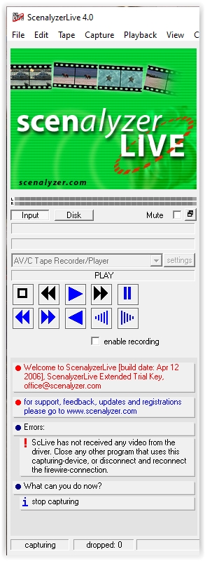

  6. My Device Manager is also showing the Legacy Windows firewire drive. The analog light is lit on the ADVC-100 and I tried WinDV without any luck. Here's what my screenshot of Scenalyzer looks like:

  7. I tried running both software programs in Windows XP compatibility mode. Scenalyzer doesn't show the above error message anymore, but nothing happens when I click Capture. Very frustrating.....
    (I connected the VCR to a TV to ensure that the VCR was in fact streaming video)
