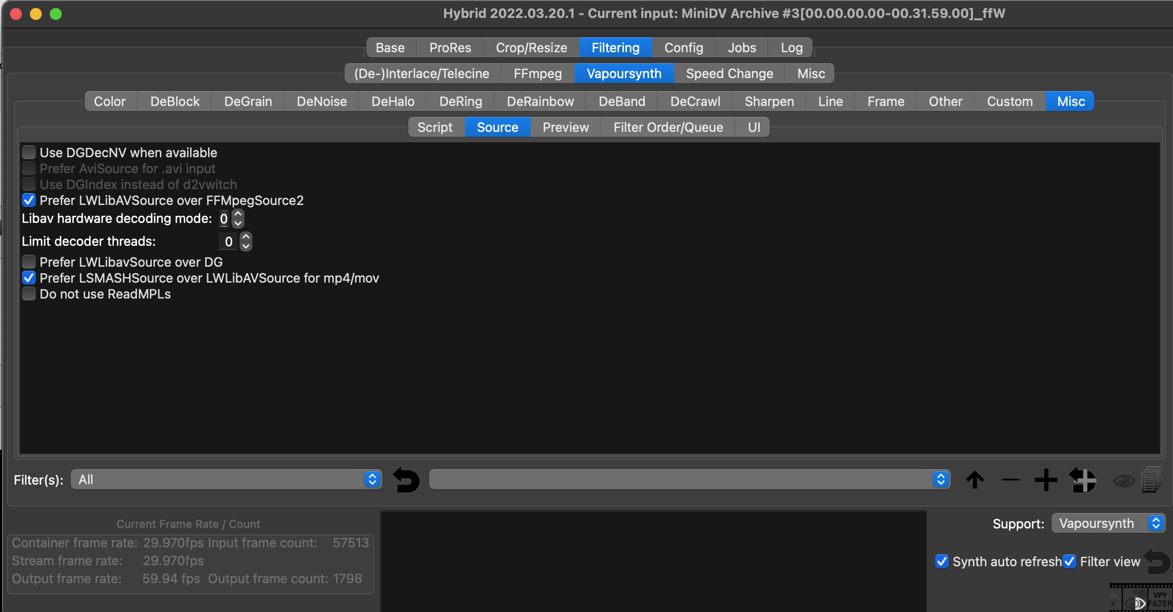

  9. Image
    [Attachment 88144 - Click to enlarge]
    These are the settings I see under source.
    I do not see how to do the script preview. And if the script preview comes up, can you change it there and add in the BestSource?
  10. Bestsource wasn't available back in 2022.
    With that version, on macos, your choices are:
    a. use LWLibAVSource
    or
    b. use FFMPEGSource2
    if both shot the problem for you, the issue probably was fixed in libav during the last three years,...
