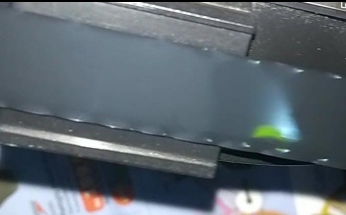

    This tape was already damaged; the owner probably tried to play it without proper treatment and damaged the sides, as shown in the photo. The only VCR I have that played it well was the Philips VR788... But I also think the VR999 isn't in very good condition. I bought it recently.
    [Attachment 88006 - Click to enlarge]
    Jun 2024
    Perth, Western Australia
    Yes both tape edges are stretched as shown by the frilling. Stretching is normally caused by playing the tape in a machine needing attention. It leads to unreliable linear audio and picture tracking. Playing a dirty tape can also stretch it. The best chance with a stretched tape is to play it on an excellent machine. For the very best results there is a way to reduce this problem but it's normally specialist work.

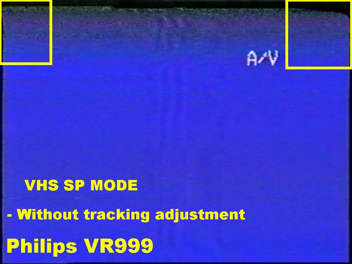

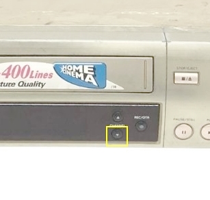

    Hello.
    I purchased this Philips VR999 player, and it appears to be misaligned. The previous owner must have unregulated the guides roles, or the misalignment was caused by something else.
    However, the VHS tapes in SP mode that I'm testing with it are misaligned at the top of the video, as shown in the photo. Even with the stabilizer on, I noticed the image shaking. These are tapes with flaws, so they require VCRs with good video stabilizers. But this player isn't working well.
    When I press the tracking button marked below four times, the video stabilizes completely, but this doesn't work well on EP tapes, only with SP tapes.
    What should I do now? I know I need an oscilloscope.
    But would using this tactic of pressing the tracking button four times to align the video be a good option for using this player?

  6. Before you conclude that the player is misaligned you should test it with a tape which is in good/reasonable condition.
    The player will usually do autotracking. By pressing the track key repeatedly you overrule the autotracking by your manual tracking. May be necessary for really poor tapes though.
    EP tapes are biests anyway. It might be difficult to find a player which will plays your poor EP tapes flawlessly .... almost a hit and miss probably.
    Dec 2022
    Brasil
    This VR999 doesn't have automatic tracking.
    I left this example in a comparison video.
    Notice that at the top of the video is the VR999, with me sometimes using manual tracking, pressing that button 4 times, and sometimes leaving it in normal tracking, without touching anything.
    In normal tracking, the screen shakes and there are these distortions at the top.
    At the bottom of the video, the VR788 does an excellent job of stabilizing the video from a bad tape.
    I've already tested a tape in excellent condition, without any problems, and the VR999 still causes distortion at the top of the video, unless I press that marked tracking button four times.
    Okay. What do I do now? I can't use it like this to convert tapes. But it would be a great help if this device were working normally.

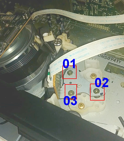

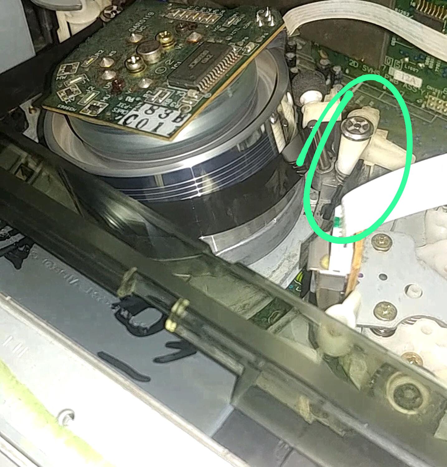

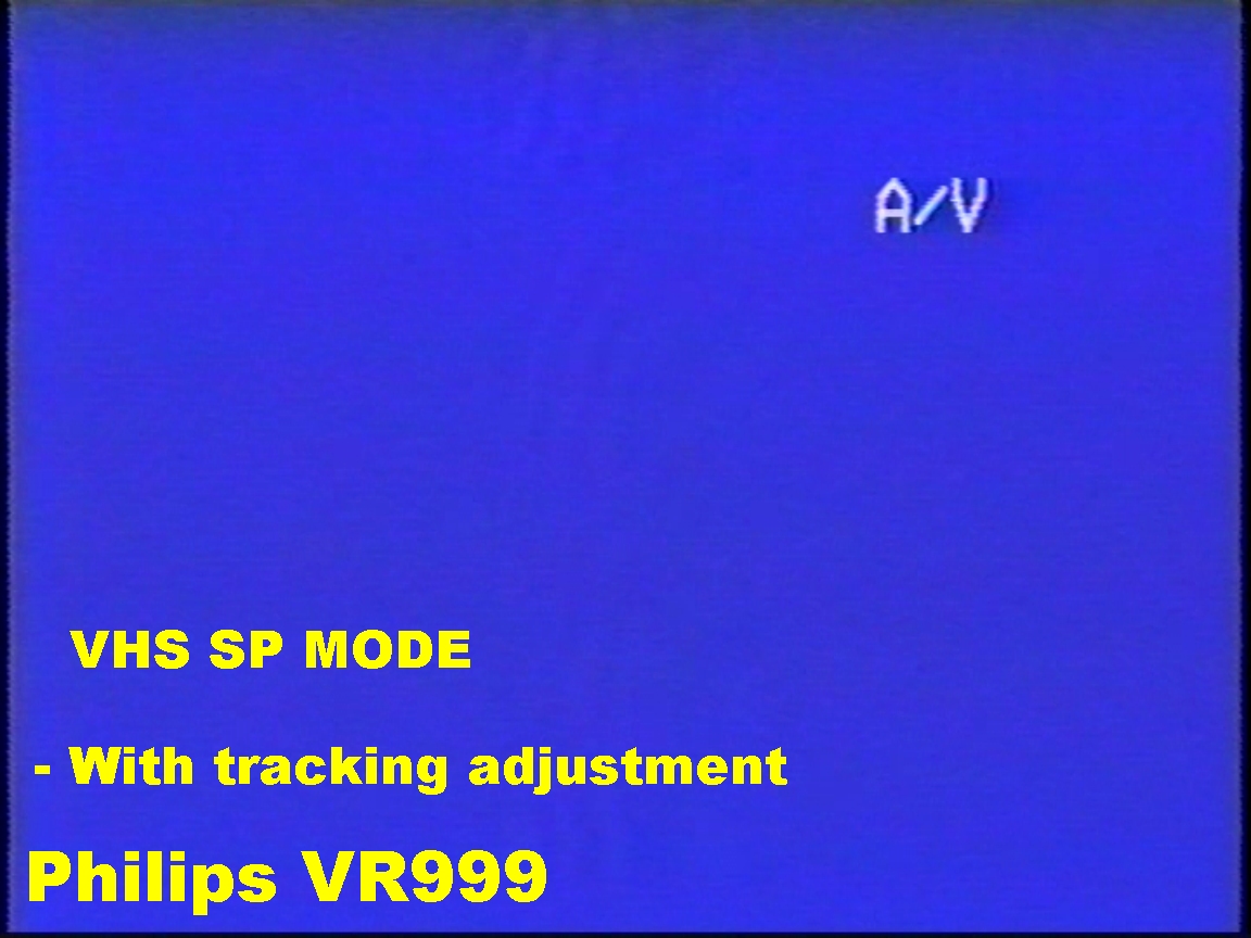

    Thanks @aramkolt for your reply.
    I have good news about the Philips VR999, which may have misaligned guides. I recently thoroughly inspected the gears; it still needed to remove some greasy debris from the guides, the underside of the head drum, rollers, etc.
    Now, with tapes in SP mode, the stabilizer is practically working fine now, after the new cleaning.
    Something interesting, which I hadn't noticed before, is that the right guide roller, shown in the photo, the white part, was a little stuck when it should be rotating. I added a little isopropyl alcohol, rotated it back and forth, and now it's flexible and rotating again. Could this be causing these image distortions?
    Of course, I didn't change the guide alignment; I know it's calibrated to the millimeter at the factory.
    The only problem now is that the tapes recorded in EP still tend to have a slight wobble at the bottom or top, but not all of them, I will test with a few more tapes.
    I left two examples, of a capture of the same bad tape in SP mode and now being stabilized, and a good tape also in SP.

    Congratulations. In cleaning the VR 999 tape path and freeing up the rotating guide you have just given the machine part of a normal service. See my post #2!
    If you are dealing with tapes with more than normal dirt, mold etc you will need to be cleaning your VCR tape paths even more frequently than normal. Cleaning the full tape path thoroughly and without doing damage can take some time and careful concentration.
    But you still may not have cleaned the full tape path. There is the capstan shaft and pinch roller. There is the automatic head cleaner (grey foam ring just above and to the left of the guide in your photo). In fact every part of the tape path should be checked and cleaned properly. This is not advanced VCR repairs but some of "the basics".
    Why not read up from the manufacturer's Service Manual how to clean all the different parts of the tape path with the right supplies and techniques.

    This problem of not capturing audio on the right side only occurs when the tape has this problem on the sides. I believe the audio head on this device is misaligned; I'll try to align it. All other VCR models I own capture stereo audio without any issues when I play tapes like this.

    Thanks for the photo. With that tape stretch damage on both edges, audio capture problems, including possible picture problems, should be no surprise. Are you surprised?
    It's very likely that damage was caused by playing the tape in a faulty VCR. Possibly played in multiple faulty VCR's.
    The tape damage cannot be repaired.
    If other undamaged tapes play audio and picture well, I would assume the AC head is already reasonably well aligned. Only align the AC head if it actually needs aligning to the standard. But special alignment of the head to this tape cannot really solve poor capture of the edge information on a tape damaged in this way.
    But with special technique sometimes the audio playback can be greatly improved. The technique is not new. In principle it is quite simple. It has been used for a very long time by some advanced tape transfer engineers but has to be executed very well.

    In the second test to try to solve the muffled audio, I moved all the screws and thanks to a super VHS tape that when I put it before in this Philips VR999, the sound and video were completely misaligned. By fiddling with the audio head screws, I was able to stabilize the sound and video on that tape and on all others tape models for this device.
    So the problem wasn't with the video head or other things, but only with the audio head, which someone had messed with it before, my guess.
    Like I described it here before only the SP tapes were stabilizing the video, but it was happening that audio error. After I adjusted those screws, now both EP, SP and Super VHS tapes have well-stabilized sound and video, no audio glitches on the right side now.
    Problem solved 98%, I think.
    However, I noticed on an EP tape I tested yesterday that some of the colors were a little blown out.
    Since I'm not a technician, I just followed this YouTube video https://www.youtube.com/watch?v=fazLIPQqKLk
    These audio heads must be missing some minor adjustments. Can anyone help me?
    I've included two examples of the EP tape with muffled audio but no color issues, and another example with normal audio but with color issues.
    [Attachment 88622 - Click to enlarge]

    I had performed two adjustment tests on the audio head of this device. In the first test, using only a VHS tape in EP, I adjusted only the ''screw 01'' and managed to align the video on the screen. The video stabilizer also worked perfectly. However, the audio was a bit muffled.
    Screw 01 is the azimuth screw. Adjusting 01 is reasonably safe. Normally we adjust that for clearest audio. The audio is more sensitive to small adjustments of 01 than is the control track.
    But adjusting 02 and 03 is more complicated. It's not recommended to adjust them unless we know how to get it right. We dont adjust 02 and 03 for good picture or sound. We adjust them for head height and tilt (zenith) without looking at the picture or sound. You will probably find this information in the Service Manual. Always check the Service Manual before adjusting screws and trimmers.
    To solve this color popping issue, more specifically the green, do I need a specific tape? Remember, it only happened on EP tapes; on the others, the color and sound are normal.
    Maybe a slight tightening or loosening of one of these screws could solve the problem?
    I have the manual, but I don't think it talks about this.
