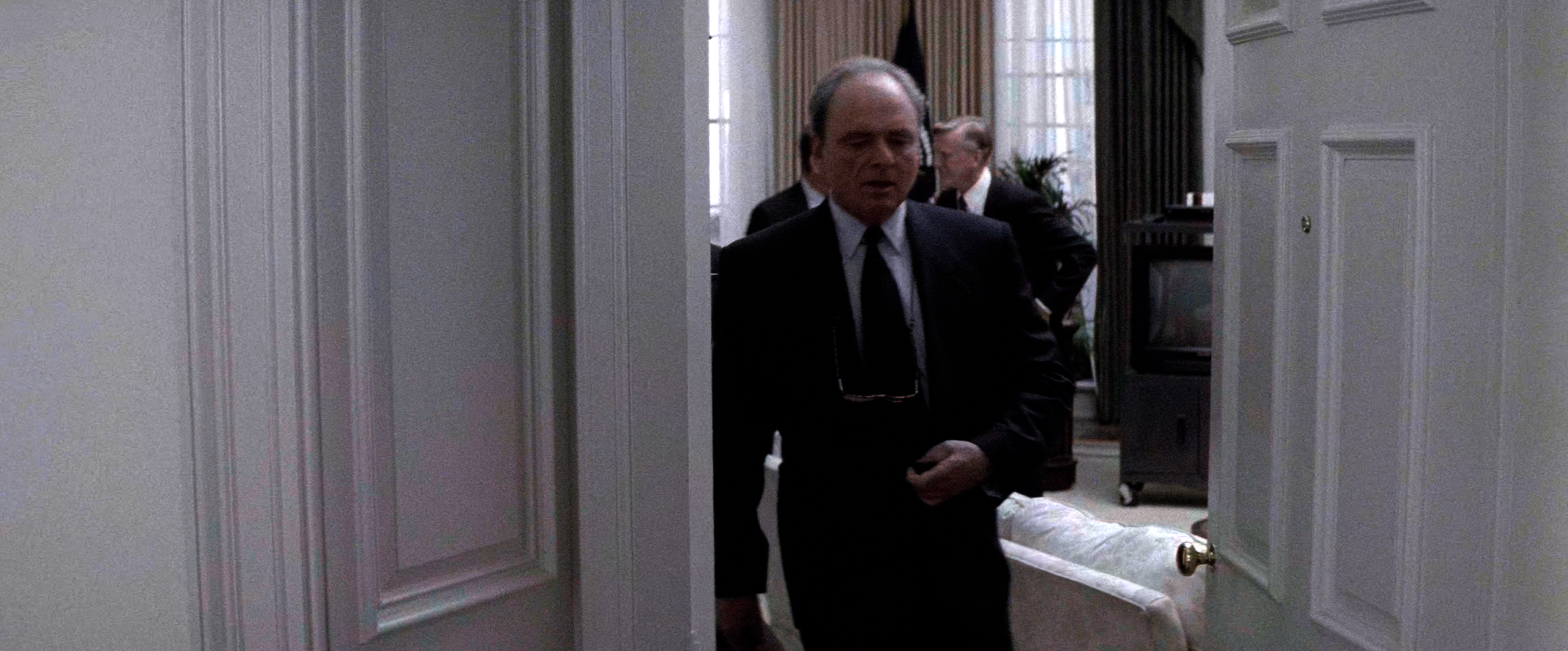

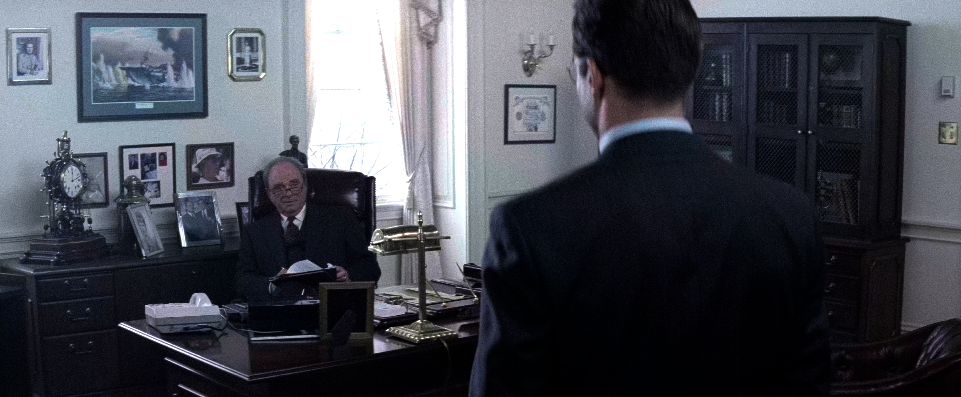

I found another issue. While the banding was solved with v210, the weird pink/green blotch problem is less pronounced, but still around. Here are some frames I took screenshots of. You can see some areas with slight pink/green shades. I think the screenshots overemphasize the problem, it's barely noticeable watching through the output in realtime, and I feel like I've seen this before elsewhere. In realtime I sort of have to wonder if it's there or not, but when I go frame by frame there are some (not all or even most) instances where there is some of this going on. It does not look like it's there in the input, but after a while I can erroneously imagine I'm seeing it everywhere if I look hard enough.

If you can't see it it's over the man in the first picture, around the window in the second picture, and to the left of the man in the third picture

I'm using the snipping tool in Windows over MPC-HD playing back the file. Snipping tool brightens the frame since I think HDR is lost which makes the problem look way worse, but it's there. Here is the -report for a segment of this recording:

Still happens with a lossless command but it looks different. More edgy than blotchy. Decklink is sending clean frames. OBS's standard NVENC encoder is able to record the same content without this problem (but drops frames and has other issues which is why I'm using ffmpeg) so I know the issue is either with ffmpeg's compression or the colors.
