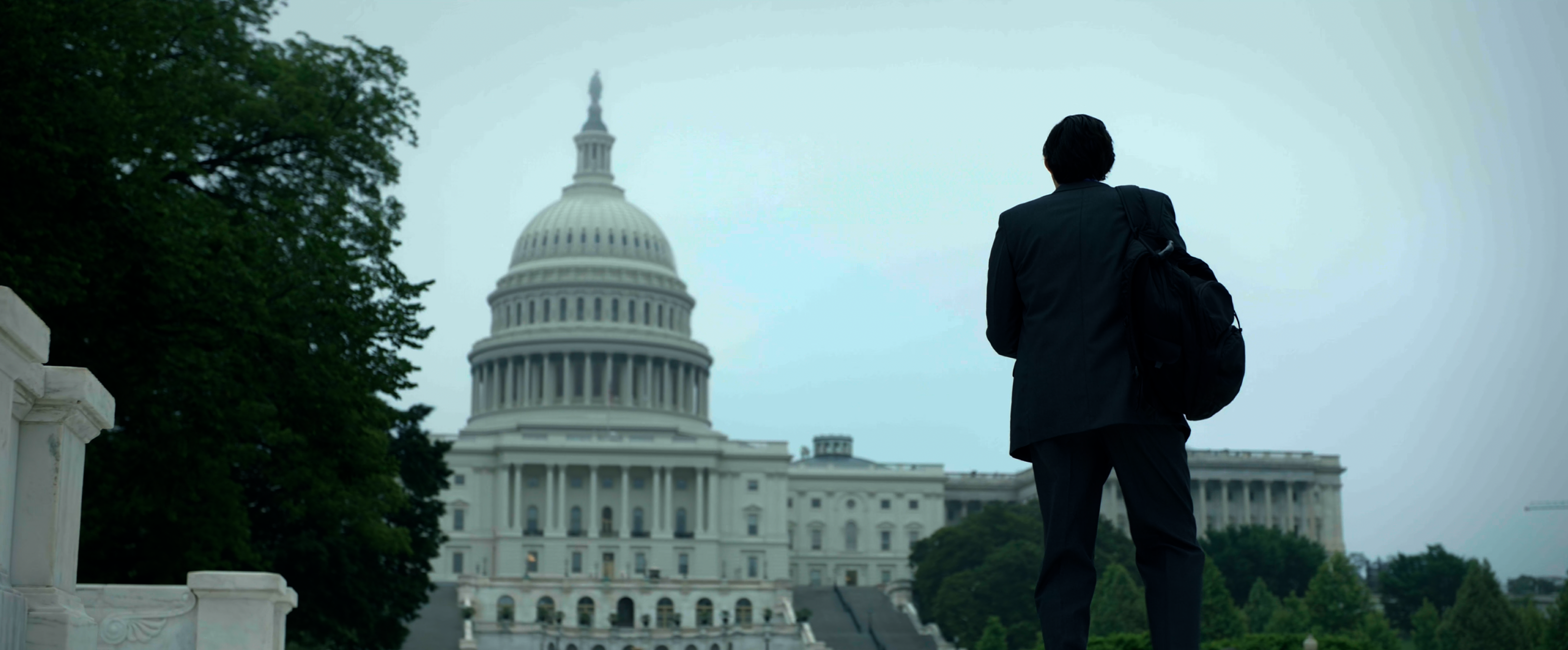

Hi all,
After a long time in some other threads getting HDR, AC3 and other things working with an ffmpeg command, I finally have a command that is working really well. I have noticed however a couple relatively smaller but related issues that look like they have to do with compression. This one screenshot from a scene happens to show both of them. The lines through the sky and then the small magenta/cyan blotches to the left of the figure are the only remaining problems. The entire movie/recording is actually really good, everything works well, HDR works properly, the colors and sharpness are good. There are just a handful of scenes per file where either the compression or the colors result in what you see in the sky and then this very minor pink/blue blotching. I could almost watch the output movie just fine, but it's just palpable enough to be a problem. Any idea how to fix that?
Here is my ffmpeg command:
And here is a screenshot showing an instance of the problem:Code:ffmpeg -f dshow -video_pin_name 1 -audio_pin_name 1 -video_size 3840x2160 -rtbufsize 2147480000 -framerate 24000/1001 -channels 6 -sample_rate 48k -sample_size 16 -i video="Decklink Video Capture":audio="Decklink Audio Capture" -filter_complex "[0:0]scale=w=iw:h=ih:interl=false:eval=init:out_v_chr_pos=-128:out_h_chr_pos=-128:flags=bilinear+accurate_rnd+print_info,format=p010le[vout];[0:1]channelmap=FL-FL|FR-FR|LFE-FC|FC-LFE|BL-BL|BR-BR:5.1[aout]" -map "[vout]" -map "[aout]" -color_range 1 -chroma_sample_location left -color_trc smpte2084 -color_primaries bt2020 -colorspace bt2020nc -strict -2 -c:a eac3 -b:a 640k -c:v hevc_nvenc -profile:v main10 -preset:v p7 -b:v 70M -bufsize:v 100M title.mkv
[Attachment 69865 - Click to enlarge]

What was the source ?
The other related problem is the significant banding in the sky, which shouldn't happen if it was 10bit chain (assuming source was 10bit and decent quality)
If it's in the source, you can try chroma denoising such as -vf chromanr(some settings); and/or adding dithering, or noise, or debanding filter such as libplacebo or gradfun . Beware that adding dithering/noise/debanding filters will require more bitrate
If it's bad upstream processing, fix that e.g. if dshow or decklink is quantizing the signal, try fixing it
If it's the result of a bad encoding/settings, use higher bitrate or better encoder . If you encode lossless, or very high bitrate, you can identify what part or proportion was hevc_nvenc's fault
If it's a display problem, and the encode was ok, try a different display / decoding chain
=> Basically, go through each step in the chain and try to fix the underlying problem. Addressing the problem later on such as adding noise to "cover it up", is less desirable than fixing the actual underlying problem - but if the source was the problem, then you might have no choice -
Those are all posterization artifacts. Usually the result of too little bitrate or too much noise reduction with 8 bit video. Are you capturing 8 bit video? Is it already posterized like that? If so you'll need a 10 bit debanding filter.
No. It's a bit depth or noise reduction problem. I suspect it's the NVENC encoder removing all the noise. Maybe in conjunction with a playback problem (video being converted to 8 bit before being converted to RGB for display). Because 10 bit video shouldn't show such prominent banding.
Note that all the "video quality" measurement tools (VMAF, PSNR, SSIM, etc.) are very insensitive to quantization artifacts. They are much more sensitive to positional artifacts. -
I just tried the same scene again with a lossless command:
and got exactly the same banding problem. It's nearly an identical frame. MediaInfo reports the bitrate as 309 Mb/s on this file. The only other procedural thing of note is ffmpeg repeatsCode:ffmpeg -f dshow -video_pin_name 1 -audio_pin_name 1 -video_size 3840x2160 -rtbufsize 2147480000 -framerate 24000/1001 -channels 6 -sample_rate 48k -sample_size 16 -i video="Decklink Video Capture":audio="Decklink Audio Capture" -filter_complex "[0:0]scale=w=iw:h=ih:interl=false:eval=init:out_v_chr_pos=-128:out_h_chr_pos=-128:flags=bilinear+accurate_rnd+print_info,format=p010le[vout];[0:1]channelmap=FL-FL|FR-FR|LFE-FC|FC-LFE|BL-BL|BR-BR:5.1[aout]" -map "[vout]" -map "[aout]" -color_range 1 -chroma_sample_location left -color_trc smpte2084 -color_primaries bt2020 -colorspace bt2020nc -strict -2 -c:a eac3 -b:a 640k -c:v hevc_nvenc -profile:v main10 -preset lossless losslesstitle.mkv

What about in terms of the chroma "blotching" issue ?
uyvy422 is the same as "UYVY", or 8bit interleaved (packed) 4:2:2 . So you have an 8bit step somewhere, which can contribute to bandingThe only other procedural thing of note is ffmpeg repeatsa number of times quickly before the recording begins.Code:[swscaler @ 00000124c70bd700] [swscaler @ 00000124c70d0b00] bilinear scaler, from uyvy422 to p010le using MMXEXT
swscale is 10bit capable , but you might try zscale instead if anything is actually being scaled (e.g. chroma) . Swscale tends to have a few more bugs -
Sorry I forgot to mention that chroma blotching is also exactly the same. How would I modify the command to use zscale? Also for reference I also tried OBS instead of ffmpeg and using its standard encoder it was able to record the same scene with no banding. OBS however has other issues which make me prefer ffmpeg.
At 309Mb/s and still the same problems , it's unlikely to be an encoding or nvenc issue . More likely some problem upstream

What "standard encoder" ? Was that libx265 ?
Also for reference I also tried OBS instead of ffmpeg and using its standard encoder it was able to record the same scene with no banding. OBS however has other issues which make me prefer ffmpeg. -
Thanks I'll give this a try now and edit this post with the results. In the meantime I tried switching from NVENC to libx265 with this command:
and got exactly the same banding and blotching problem in that scene.Code:ffmpeg -f dshow -video_pin_name 1 -audio_pin_name 1 -video_size 3840x2160 -rtbufsize 2147480000 -framerate 24000/1001 -channels 6 -sample_rate 48k -sample_size 16 -i video="Decklink Video Capture":audio="Decklink Audio Capture" -filter_complex "[0:0]scale=w=iw:h=ih:interl=false:eval=init:out_v_chr_pos=-128:out_h_chr_pos=-128:flags=bilinear+accurate_rnd+print_info,format=p010le[vout];[0:1]channelmap=FL-FL|FR-FR|LFE-FC|FC-LFE|BL-BL|BR-BR:5.1[aout]" -map "[vout]" -map "[aout]" -x265-params "range=limited:colorprim=bt2020:transfer=smpte2084:colormatrix=bt2020nc:chromaloc=2:master-display=G(13250,34500)B(7500,3000)R(34000,16000)WP(15635,16450)L(10000000,1):hdr10=1:max-cll=1000,300" -color_range 1 -chroma_sample_location left -color_trc smpte2084 -color_primaries bt2020 -colorspace bt2020nc -c:a ac3 -c:v libx265 -profile:v main10 -preset: ultrafast -b:v 80M -maxrate:v 100M -minrate:v 70M -bufsize:v 100M outputx265.mkv
To answer your question, OBS' standard encoder is NVENC. It has a "Standard Encoder" and then "Advanced" (ffmpeg). The Standard Encoder worked great except for occasional frame drops. The problem was OBS only supported one basic audio format with the standard encoder and I needed AC3 and EAC3, hence ultimately using ffmpeg itself. Using P010 & ffmpeg inside OBS caused the recording to have 90% frame loss and fail for reasons nobody could figure out, and since OBS doesn't officially support that I moved on to just using ffmpeg separately as I am now, and have had much more success. This banding issue is the only remaining issue and then I have a perfectly working setup.
Update: Same problem using zscale. I incorporated it into the command so I used:
and the problem is the same.Code:ffmpeg -f dshow -video_pin_name 1 -audio_pin_name 1 -video_size 3840x2160 -rtbufsize 2147480000 -framerate 24000/1001 -channels 6 -sample_rate 48k -sample_size 16 -i video="Decklink Video Capture":audio="Decklink Audio Capture" -filter_complex "[0:0]zscale=f=bilinear:cin=topleft:c=topleft,format=p010le[vout];[0:1]channelmap=FL-FL|FR-FR|LFE-FC|FC-LFE|BL-BL|BR-BR:5.1[aout]" -map "[vout]" -map "[aout]" -color_range 1 -chroma_sample_location left -color_trc smpte2084 -color_primaries bt2020 -colorspace bt2020nc -strict -2 -c:a eac3 -b:a 640k -c:v hevc_nvenc -profile:v main10 -preset:v p7 -b:v 75M -bufsize:v 100M test.mkv

did zscale report a similar message as swscale ?
you can add -report to ffmpeg commandline to write a log to see if there are any other clues
Did you verify if decklink through -f dshow work in 10bit ? Do you need an input switch like -pix_fmt yuv422p10le ? was does obs use ? -
It's a Blackmagic Decklink card that's capturing a 3840x2160 HDR10 23.976 Hz 4:2:2 input over HDMI. For experimentation I just tried adding
to the command which did nothing and if anything may have made that pink blotchiness a little worse so I took that back out.Code:-rc-lookahead 15 -spatial-aq 1 -aq-strength 8
I think your card is sending 8bit 4:2:2
how about

zscale did not give off the same message. I have the zscale -report output which you can see here:
https://docs.google.com/document/d/1hnZyg9kJAFSLwxkdFbAQvb4q74yY2FdKHKveCM4KJlI/edit?usp=sharing
I've looked into dshow & 10 bit in the past and it was unclear. I do know however that besides this banding problem that only occurs in a limited number of scenes (usually scenes showing skies and bright light sources) the output is flawless color accurate HDR that works perfectly. It's only with these types of gradients is NVENC outputting such an unsightly product.
I tried adding -pix_fmt yuv422p10le and it gave me:
with the same banding problem in the output file. OBS doesn't give more detail on exactly what it uses.Code:Incompatible pixel format 'yuv422p10le' for codec 'hevc_nvenc', auto-selecting format 'yuv444p16le' [swscaler @ 000001af1283ed40] [swscaler @ 000001af39c420c0] bilinear scaler, from uyvy422 to p010le using MMXEXT
Failed with this error:
UsingCode:[in#0 @ 00000225eb99f380] Unknown input format: 'dshow=pixel_format=yuv422p10'
Code:ffmpeg -f dshow=pixel_format=yuv422p10 -video_pin_name 1 -audio_pin_name 1 -video_size 3840x2160 -rtbufsize 2147480000 -framerate 24000/1001 -channels 6 -sample_rate 48k -sample_size 16 -i video="Decklink Video Capture":audio="Decklink Audio Capture" -filter_complex "[0:0]scale=w=iw:h=ih:interl=false:eval=init:out_v_chr_pos=-128:out_h_chr_pos=-128:flags=bilinear+accurate_rnd+print_info,format=p010le[vout];[0:1]channelmap=FL-FL|FR-FR|LFE-FC|FC-LFE|BL-BL|BR-BR:5.1[aout]" -map "[vout]" -map "[aout]" -color_range 1 -chroma_sample_location left -color_trc smpte2084 -color_primaries bt2020 -colorspace bt2020nc -strict -2 -c:a eac3 -b:a 640k -c:v hevc_nvenc -profile:v main10 -preset:v p7 -b:v 75M -bufsize:v 100M test.mkv
In your log with -f dshow :
dshow is sending 8bit in your setup . HDYC is one fourcc for 8bit 4:2:2 used by BM cards[dshow @ 0000017914e10400] attempt to use full range for HDYC...
Input #0, dshow, from 'video=Decklink Video Capture:audio=Decklink Audio Capture':
Duration: N/A, start: 0.268523, bitrate: N/A
Stream #0:0, 1, 1/10000000: Video: rawvideo (HDYC / 0x43594448), uyvy422, 3840x2160, 23.98 fps, 23.98 tbr, 10000k tbn
Try similar to yuv422p10 , such as v210
-f dshow=pixel_format=v210Last edited by poisondeathray; 19th Mar 2023 at 15:09.
That fixed it! Banding is gone. Although ffmpeg is not accepting that syntax (-f dshow=pixel_format=v210) for some reason. I instead added "-c:v v210" which works great. v210 was actually in an earlier version of my command until I cut it because someone in another thread was questioning why it was there, and it seemed to work without it except for this problem. Thank you!
Cheers;
Please post your full command so other people with similar setup encountering similar problems can see the solution -
Sure, it's:
Code:ffmpeg -f dshow -c:v v210 -video_pin_name 1 -audio_pin_name 1 -video_size 3840x2160 -rtbufsize 2147480000 -framerate 24000/1001 -channels 6 -sample_rate 48k -sample_size 16 -i video="Decklink Video Capture":audio="Decklink Audio Capture" -filter_complex "[0:0]scale=w=iw:h=ih:interl=false:eval=init:out_v_chr_pos=-128:out_h_chr_pos=-128:flags=bilinear+accurate_rnd+print_info,format=p010le[vout];[0:1]channelmap=FL-FL|FR-FR|LFE-FC|FC-LFE|BL-BL|BR-BR:5.1[aout]" -map "[vout]" -map "[aout]" -color_range 1 -chroma_sample_location left -color_trc smpte2084 -color_primaries bt2020 -colorspace bt2020nc -strict -2 -c:a eac3 -b:a 640k -c:v hevc_nvenc -profile:v main10 -preset:v p7 -b:v 75M -bufsize:v 100M title.mkv
