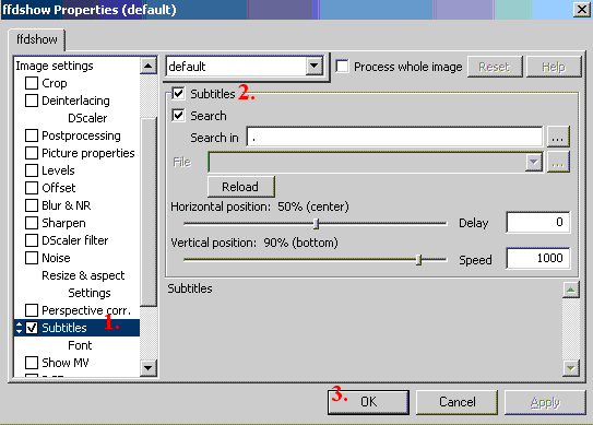

or Using ffdshow filter
Install ffdshow and run the ffdshow Configuration from the Start menu->ffdshow->Configuration.
1. Select Subtitles in the menu to the left
2. Enable the subtitles.
3. Hit Ok.

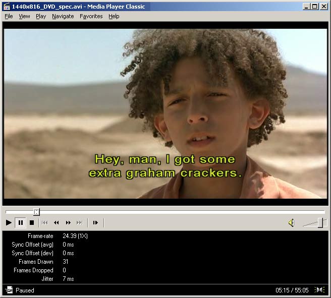

Now should the subtitles appear if you play the video with Media Player. If not then the subtitles may be in wrong format.

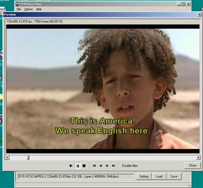

Start TMPGEnc and close the Wizard. First change the Directshow priority in TMPGEnc (the Directshow reader reads the subtitles the same way as Media Player).
1. Select Option->Enviromentel Settings
2. Select VFAPI Plugin
3. Right click on the Directshow Multimedia File Reader and select Higher Priority, repeat it until it is on the top of the list.
Open the video with wizard or manual. The subtitles should now appear. Use File->Preview in TMPGEnc to check that you can see the subtitles before encoding.
Last just convert to VCD or SVCD or DVD as usual.
