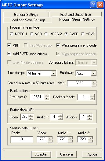

Try:
--- TMPGEnc ---
VBV Buffer size = 224
--- bbMPEG ---
Movie offset seconds = 0
Output Settings:
Author:
- VCDEasy
Optional:
- Nero (Burn image .cue) -
