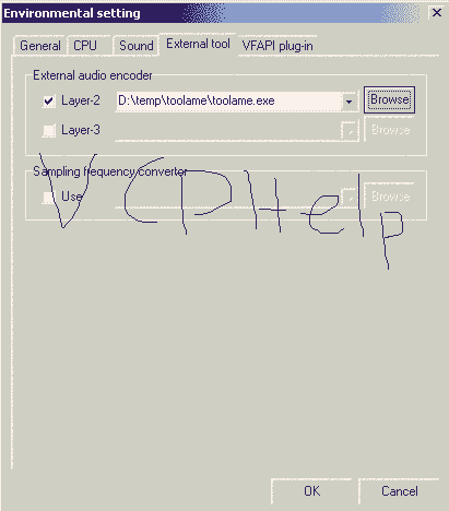

    by using an external audio encoder because TMPGEncs own audio encoder is not the best. One of the best audio mpeg layer 2 encoders is tooLame, download and extract all files to a folder. In TMPGEnc under Options->Environmental Settings->External tools select Layer 2 and browse for the toolame.exe
