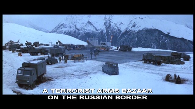

    I am using virtual dub to encode Tomorrow Never Dies to DivX. As some of you may know, thay have forced subtitles that appier off the movie screan as regular subtitles. These are forced and can not be removed (using dvd programming)(Example below). My problem is, that when i preview them in vdub, the subtitles do not play. I think I need to rip the subtitles and make them perminent. My question is How do i rip these subtitles?
    Thankx in advance, James
