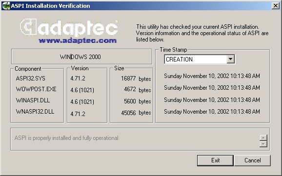

I am using the guide from:
https://www.videohelp.com/dvdmediaform.php?advdinfo=1#advdinfo
I am using ASPI 4.71.2, here is the screenshot, does anyone know how I can actually read the media info?
Results 1 to 8 of 8
Btw, I just did a FORCE ASPI with version 4.6 (all 4 files are now 4.6) and still the same problem
