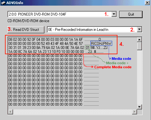

With DVD+R/RW you can use the first 00 - Physical format information to get the complete media information.Originally Posted by StudeBarc
But it might be a good idea to have a button for "Complete media code" that shows the ASCII data for "Physical format information" if it's a DVD+R/RW media and the ASCII data for "Prerecorded information in lead-in" if it's a DVD-R/RW media since these commands are not very logical for a new user.
It would be even better if this function for "Complete media code" only displayed all the lines before the first line with zeros in the hex data so you directly can copy the info when you add media to the DVDRHelp's media list (ie like the "Complete media code" described here).
