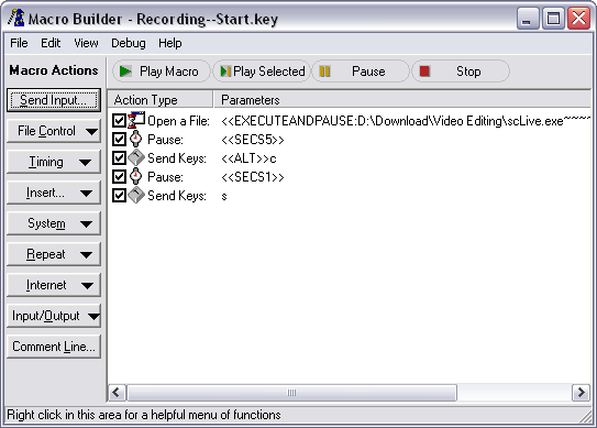

To create a new macro, open the main MacroMagic window and select “Create New Macro” at the bottom of the screen. This opens up a wizard. The next screen will have the radio button “create a macro step by step” already selected. Enter Next. On the next screen, type in the name of your choice (I used “Recording—Start”) and then enter Next. The next screen will be entitled “Select Macro Triggers”. Go to the bottom option “Place a Windows Shortcut…………..” and select “On Programs Menu” and enter Next. This brings you to the main MacroBuilder dialog box. The only three options used to create these simple Macros are “Send Input, File Control, and Timing”. Click on these and a sub-menu will be displayed showing specific actions and options. I would recommend you “explore” the various options just to learn the program and its flexibility.
Here is the resulting “Recording—Start” macro I use.
Line 1 (File Control) loads Scenalyzer. Line 2 (Timing) says wait for 5 sec. This is to make sure that you’re properly connected to your input device. Line 3 (Send Input) sends Alt-c (capture). Line 4 (Timing) waits 1 sec. Then line 5 (Send Input) sends “s” to start capturing. This whole process corresponds to the actual keystrokes you would use for beginning a capture. I always insert delays between commands to be on the safe side.
Once you’ve completed your macro, close the MacroBuilder box. This results in a new Box “Create an Advanced Macro”. Enter Next. The next screen asks “When Should this Macro be Created?” Enter Next. The next screen gives a summary of your macro—enter Finished. This will exit the Wizard and you will return to the main window. You should see the new macro you’ve created in the list.

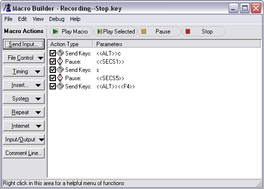

You then repeat the process and create another macro to “stop recording”. Here is the “Recording—Stop” macro that I use.
Same logic. Alt-C, pause 1 sec, send “s” to stop capturing, wait 5 sec., then ALT-F4 to exit Scenalyzer. Very simple.

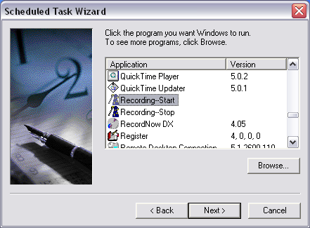

Once you’ve created and tested the two macros, you then use the Windows Task Scheduler to specify the actual date and start times. Task Scheduler can be found under “Start/All Programs/Accessories/Systems Tools”. Open Task Scheduler (I also create a program shortcut on the Desktop) and click on “Add Scheduled Task” which will start a wizard. Click “Next” to begin. On the next screen, scroll down and select the macro “Recording-Start” and then “Next”.
On the next screen, type in a name of your choice and then select “one time only” and enter “Next”. Then specify the start time and the date. If using XP Pro, you’ll have to enter your password on the next screen. Enter “next” and then “finish” on the last the last screen.

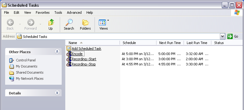

Once you have done this the Scheduled Task window should look as follows.
In the above example, I have also created a macro to begin encoding. In this case, I began capturing at 3:00PM, stopped capturing at 4:55PM, and then began the encode process at 5:00PM. In this case, I used the MainConcept encoder, although you could easily create macros for other encoders as well. I’ve also created a macro to begin encoding using the CCE Basic Encoder. It’s an even simpler macro—one line to begin processing the file in batch mode—and a second to shutdown the system after the encoding has been completed.
Once you have made your first test capture, you can simply change the start and stop times for future captures by opening Task Scheduler, “clicking” on each macro, “click” on the Schedule tab, and then changing the start date and time. It’s that simple.
