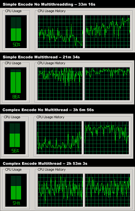

I started encoding on the dual for (of course) one reason. TMPGenc is a mulththreaded app. So I've been tweaking with the performance a bit and have come upon something interesting and rather dissappointing regarding TMPGenc's multithread performance. When I got unexpected encoding times I decided to do some controlled testing. I've created an image to present my results. The details of the tests are explained below.

Okay now take another look at the results of my testing. When going from no multithreading to multithreading in the simple encode the encoding time is greatly cut down. Cpu utilization is acceptable and was generally hanging around 80% compared to 50% in the no mulththread test. With the complex encode however it is a much different story. The encode time is only cut by a small percentage and the cpu utilization stayed mostly at 50% with occasional jumps up to 70 - 80%. The complex multithreading test was certainly different from the no multithread test, but nothing near the speed increase I want from a multithreaded app.
Here is the most interesting part
Difference between multithread and no multithread tests
Simple = 11m 42s
Complex = 13m 53s
Nearly the same aren't they? This says only one thing to me. TMPGeng is certainly a multithreaded app however only its core encoding processes actually use multithreads. Other encoding options are left to run as single threads just like they would have on a single CPU system.

most filters are not MP enabled on almost any app -- even very high end ones .. though everything else can be in the app ..
I don't use TMPGenc so this may not apply.....
- Try to frame serve using avisynth (and/or) virtual dub. You could spread the filters out across all of the apps (if you use multiple filters). This should really crank up the cpu usage. If you use one 'big' filter (high settings), try to use a couple different ones across the apps.
- Do the prefiltering in a vdub run as above, and save to mjpeg. Then encode. This may increase speed due to reduce memory usage, vs the bullet above.
I do this with avisynth and vdub, on a dual 1900. I can definately get higher fps and cpu usage this way. 18fps in vdub and ~90% on both cpus for heavy filtering of captured cartoons. My dual P3 933 could only do about 7fps on the same filters. While I'm blathering about my personal experience, I thought I'd mention that I've been using the MainConcept encoder. BJ_M posted lots of good stuff about it. It produces quite a good encode (at default DVD VBR settings). It gets to ~90% on both cpus AND encodes at 2x real time on my machine. Yes, that would be a 1hr 40min movie in about 50min.
I don't know why I ever wasted my time on cce 3 pass vbr. :P
