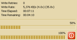

  22. I just burned 2 dvd-rs riteks at 4X...both took 12 mins (3.6GB iso).
    I'm probably gonna be up burning like a christmas boy tonight. I wasted about 5 or 6 hours tonight on this crap and when I was burning 2X it reminded me back in 1997 when I bought a smart-on 2X cd burner for $329 at costco. I had to search for a week for a casio watch that had a timer (nowadays they all have timers) so I could set it to 40mins and then come back and pop in a new cd. I feel like I just got a 4X cd burner that can burn in 20mins...yee haw!

    I think I'm on my 6th dvd-r...4X....this is better than sex at 2:04AM.

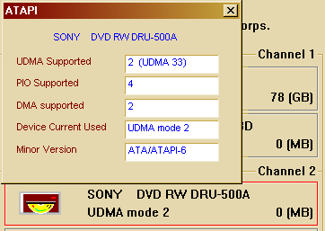

    Might as well tell you how I have it currently setup ...not that it makes a difference. It's definitely the firmware.
    pri master = hd
    pri slave = lite-on dvd-rom
    sec master = dru500ax
    sec slave = nothing
    using ATA133 cable....any ide cable will do I'm sure. Since it only supports UDMA 2 or 33MB/sec. This is on win2k sp3.
