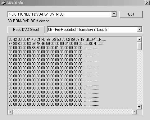

    I was told that PC Club had some 1x Generic media for sale that burns at 2x speed (cost = ~80 cents/DVD-R). I used ADVDInfo to test my DVD-R media to see which brand it was. I was told that the 2X speed would be with Sony media starting with A2VK430. My 1st batch of 25 disks worked great at 2x speed. But I bought three more packs of 25 with the A2VK430 code and they are burning at 1X speed.
    Here's my ADVDInfo results:
    1st batch (typical code: A2VK4309L262 300375) that worked at 2x speed:

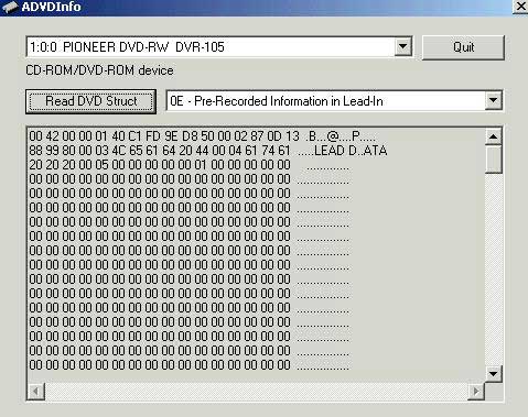

    2nd batch (typical code: "A2VK4307L082 08882" or "A2VK4307K202 05857") that didn't work at 2x speed:

    Then it was a Sony. But these subsequent batch of 25 disks don't follow this rule and only burn at 1x??? Can anyone shed some light on why I've manage to buy 1x "Lead Data" media instead of "Sony" media???????
