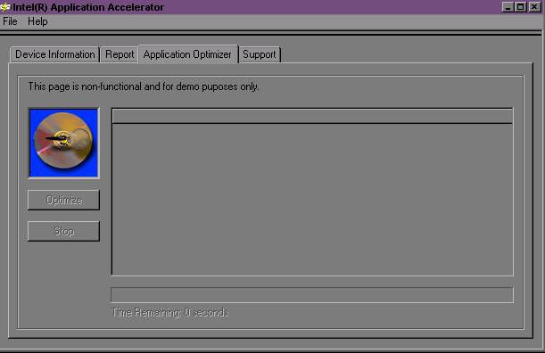

  18. it would greatly help if i knew where to get these programs at.
  19. Ok heres what i get with soft sandra, from this point what shall i do next?
    I am going to install the application accelorator, after installed should i re-check and connect both the dvd-rw drive and the cd-rw drive? Make it on the same ide cable? Or make it where hdd is master, cd-rw slave on same ide then dvd-rw master on one ide cable!!
    I really appreciate your help!!!!!!!!

    INTEL APPLICATION ACCELERATOR
    Just opened the app myself..No tweaks visible, but LIKE SANDRA, it gives alot of info..just when you think there's a page with tweaks.....
    this funny page: SCREENSHOT BELOW
  25. Ok, i have my app accelerator oppened, and it seems i have a different version than you do? Anyways, i dont get that screen for optimization! But when i looked through the help index i found that i can do tweaks, so what i did was set the transfer mode limit-it was originally set to no limit, so i set the cd-rw to UDMA-2, and the dvd-rw originally set to no limit is now on UDMA-2 also.
    Before i did these teaks, after i installed the accelerator i tried once again to read from both the drives, and it worked for the frst time, the only bad side is that anytime i read/burn my read buffer is low, and that before any installs my read buffer was always at least 98%. The other bad side is that the comp still freezes not when reading or writing cd-r's using both drives at the same time, but when i try to scan my computer for viruses using mcafee virus scan online, when i scan the whole computer i still recieved the freeze!!!!
    Any sudgestions on the UDMA-2 transfer mode limit?
    Maybe set my cd-rw drive lower than udma-2(i dont know what im talking about or what exactly these settings do, im just firguring that these are some special transfer rates from slowest to highest which is UDMA-2/5
