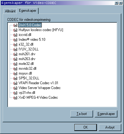

Ahh... Nimo... Don't touch it! And do absolutely not install it. I did, and almost had to reformat my drive. Uninstall Nimo. Carefully uninstall every codec that's not part of your Windows install, then selectively install the codecs that GSpot tells you you are missing. No more, no less.
Use Control Panel, Sound and Multimedia, Hardware (??? at least that's the translation for my Swedish localisation of Windows 2000), Video-CODEC, Properties, then Properties tab.
Here you see DivX5, XviD, VFAPI and Video Server Wrapper Codec (From VirtualDub I think...)
