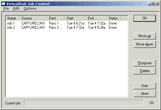

Then hit F4 to bring up the job control.
You should see your 2 jobs in the VirtualDub Job Control window
Click 'Start' and your off!
Hope this helps!dj matty b - Open the video file you want to encode
