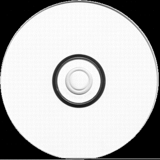

Here's the top of the Sony. The White part is injet printable, it feels like a label/matte paper. The inner circle has silver ring, not black.

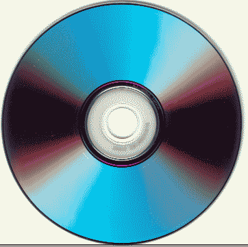

Here's the bottom.

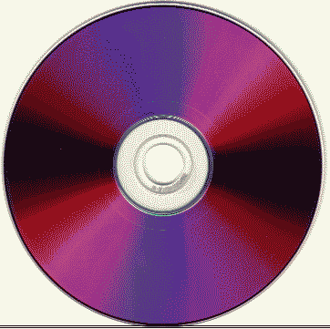

For contrast, here's a Ritek G03
The tops of those DISKS are EXACTLY like the ones I have. HOWEVER, the bottom of my disk almost exactly resembles the Ritek bottom you uploaded!it feels like a label/matte paper. The inner circle has silver ring, not black.
The blueish dye on those Sony's you have is definitely different then the dye I have on these ACCU. So basically, the only difference is that the top of my disks and your disks are EXACTLY the same, with the "silver" ring in the middle. But the dye used for your disks and my disks are different. Pretty interesting, but you did say maybe the only difference was the dye, so it looks like you are right. I still personally find that very interesting because I really wonder which of the two dyes are better. What do you think? -
The scanner didn't get the color exactly right.
The difference is that the Riteks are a deep, deep, very dark purple, where as the Sony's are a lighter purple and much more refelctive, almost mirror like.
