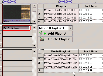

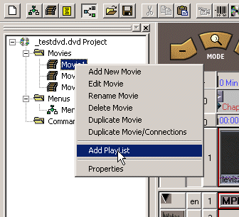

    Now add a Playlist to each movie.

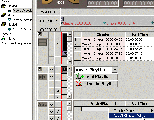

    Double click on each playlist and do as indicated - Add all chapter points. This is where you can add or delete certain chapters to or from the playlist to play whatever chapters you want. If you require a playlist with all chapters AND one with modified chapters for a movie then be sure to create multiple playlists for that movie.

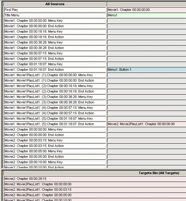

    Your Playlists should look as follows.

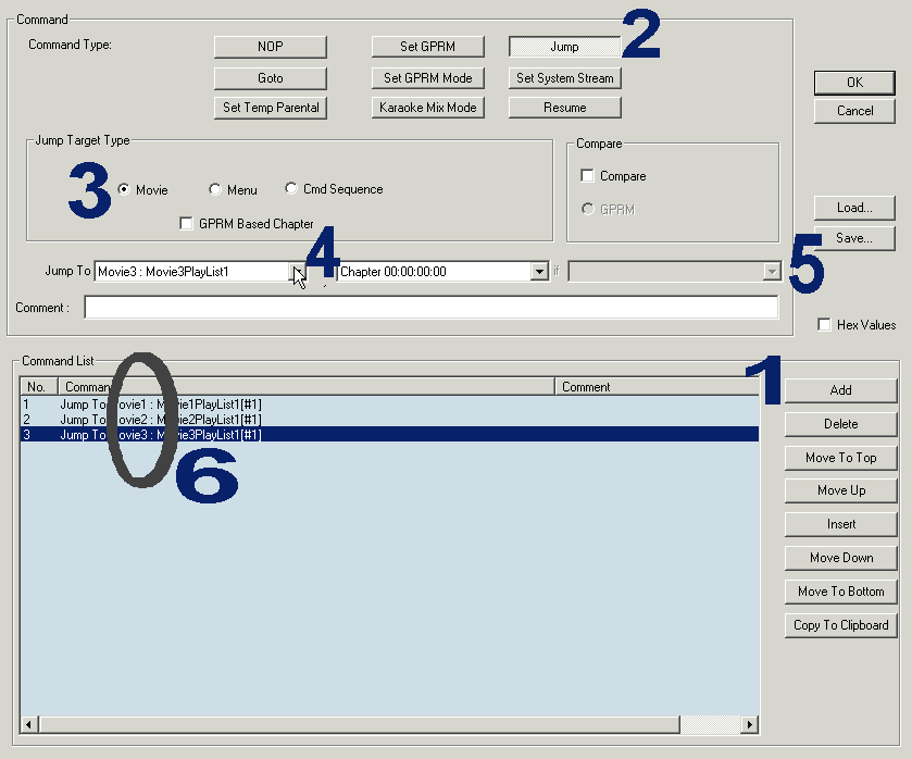

    Add new Command Sequence.
    Follow the numbers. Make sure your movies in the list are in the correct order (#6). Repeat steps 1 through 4 to add all of your episodes.

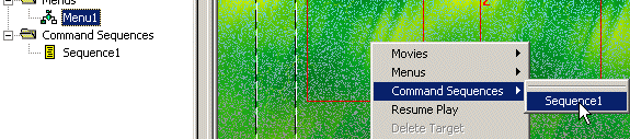

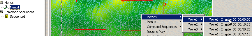

    Link your buttons to the command sequence/s and the individual movies by right clicking on the button and select the Movie, Menu, or Command Sequence.

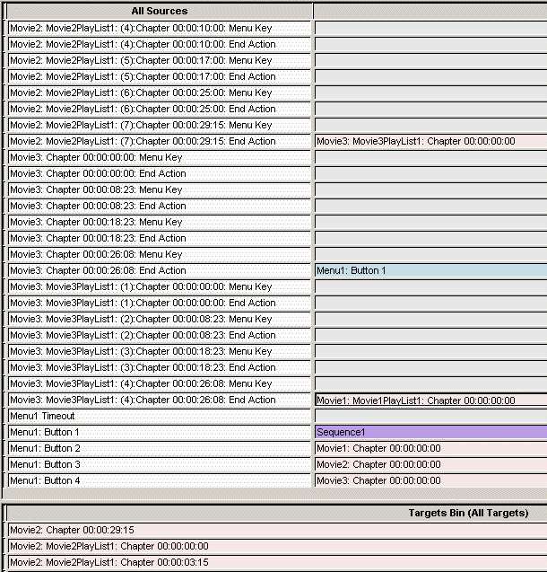

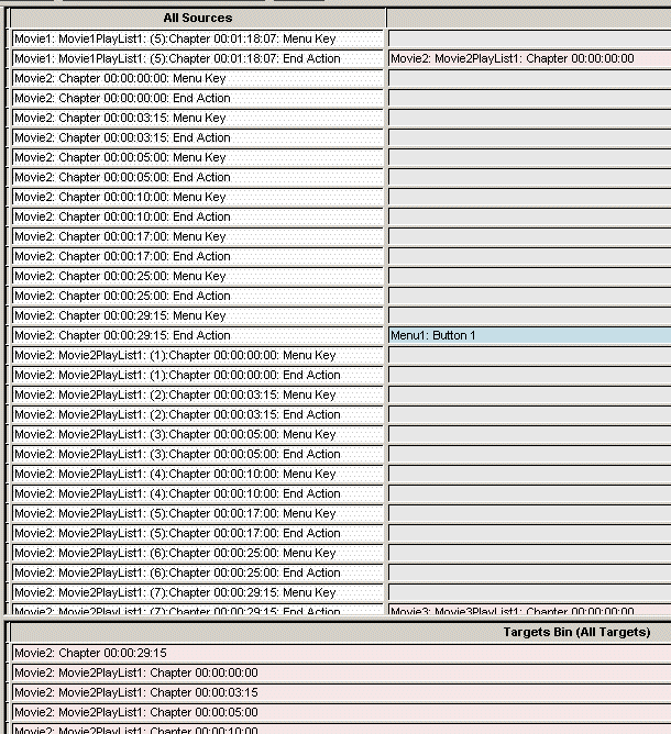

    Edit your connections to resemble the following. Pay attention to the end actions. The Actual end Chapter should flip back to the menu. The end Chapter in the playlist should flip to the first chapter in the playlist of the next media you want to play.
    Note the end action of the last chapter of the last movie is set to go back to the first playlist - Chapter1, this will loop the video continuously. Shoot it back to the menu if you don't want this.

  8. I'm stuck while trying to backup X-Files season discs and I'm using Maestro v2.9.. I'm at the following point in the process:
    "Link your buttons to the command sequence/s and the individual movies by right clicking on the button and select the Movie, Menu, or Command Sequence." ??
    By right-clicking on what button?? I tried right-clicking on every button I could think of and could not get anything resembling the 'dropdown' menu as in the image above (Movies, Menus, Command Sequences, Resume Play..) ??
    Please advise..
  9. You have to draw your buttons first; use the left button to drag and draw a button/s on the menu background, then right click on the area of the button. When I put 3 movies on one disc I put the cover art of all three on a background in Paint Shop Pro, then import and draw buttons around the art and... well you know.
