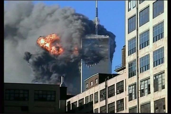

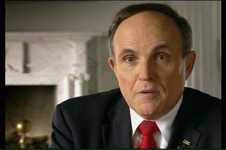

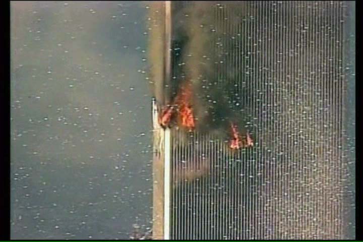

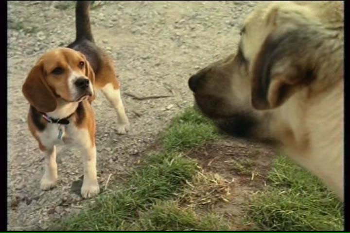

  6. Here are a few snaps taken with CineMaster 2000 software DVD player from a M2V created with CinemaCraft 2.64 CBR 9378 kbps. The original clip is from a 911 special that HBO aired last year. I captured the HBO clip from a DSS UltimateTV to the ReplayTV via Monster Cable S-Video wire. Then transferred the file to my PC using DVArchive via Ethernet.
    Following steps in descending order:
    DVD2AVI -frameserve, demuxx audio-
    VFAPIConv-1.04-EN –creates fake .avi
    VirtualDub –saved off fake avi as 24-Bit RGB uncompressed
    CinemaCraft 2.64 – single pass CBR interlaced encode
    Used Photoshop to convert .bmp screen shots into *medium quality* jpg

  10. This snap was taken directly from an authored DVD that was created using the ReplayTV’s captured file as a source.
