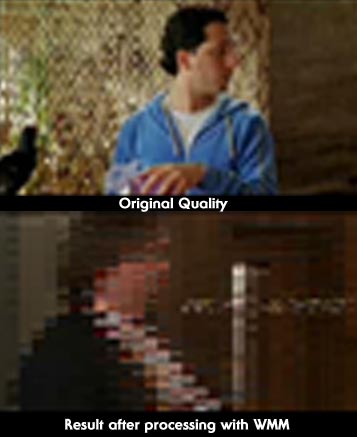

    I then tried to open the previously fixed ASF files. They are actually opened, but with a big quality loss (see attached image at the end). That's for ASF.
